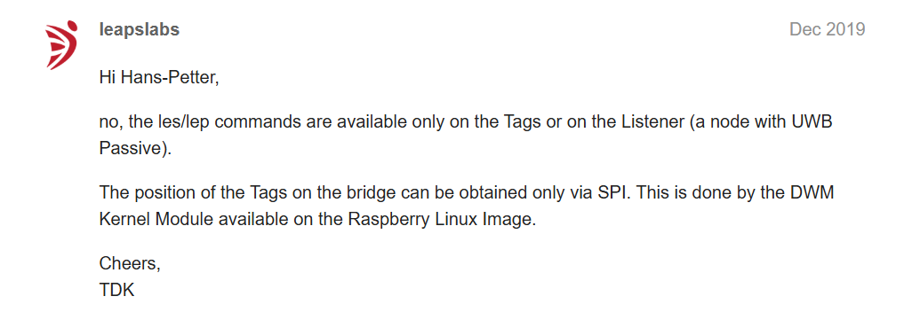

plz reply to upper thread where i posted the screenshot
Hi @AYUSHY7
in the API manual you can find the dwm_backhaul_xfer command + related description. It is super complex to make this work as you need precise timing to be able to transfer all the data in time. That is the reason why only the RPI 3B is supported. Any newer RPI is not fast enough to maintain the required timings.
We are not providing support for this command - it is too complex to implement it.
