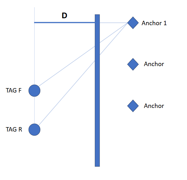

Hello. I am using develpment kit and I would like to know if it is possible to set configurations different to the ones we have in the user manual.
What I would like to do is to create a line of anchors (receivers) separated betwen them 30-40 meters and 2 tags (which have a constant distance between them) transmiting.
Idea is not to position de tags in x,y,z. I only need the distance between each tag to same anchor. (see in the picture Tag F and Tag B to anchor 1)
Anchors will have a very well known position in the space.
How is the best way to achieve it???
I am using MDEK deveopment kit but I am open to buy any other equipment if necesary
Thank you in advance
