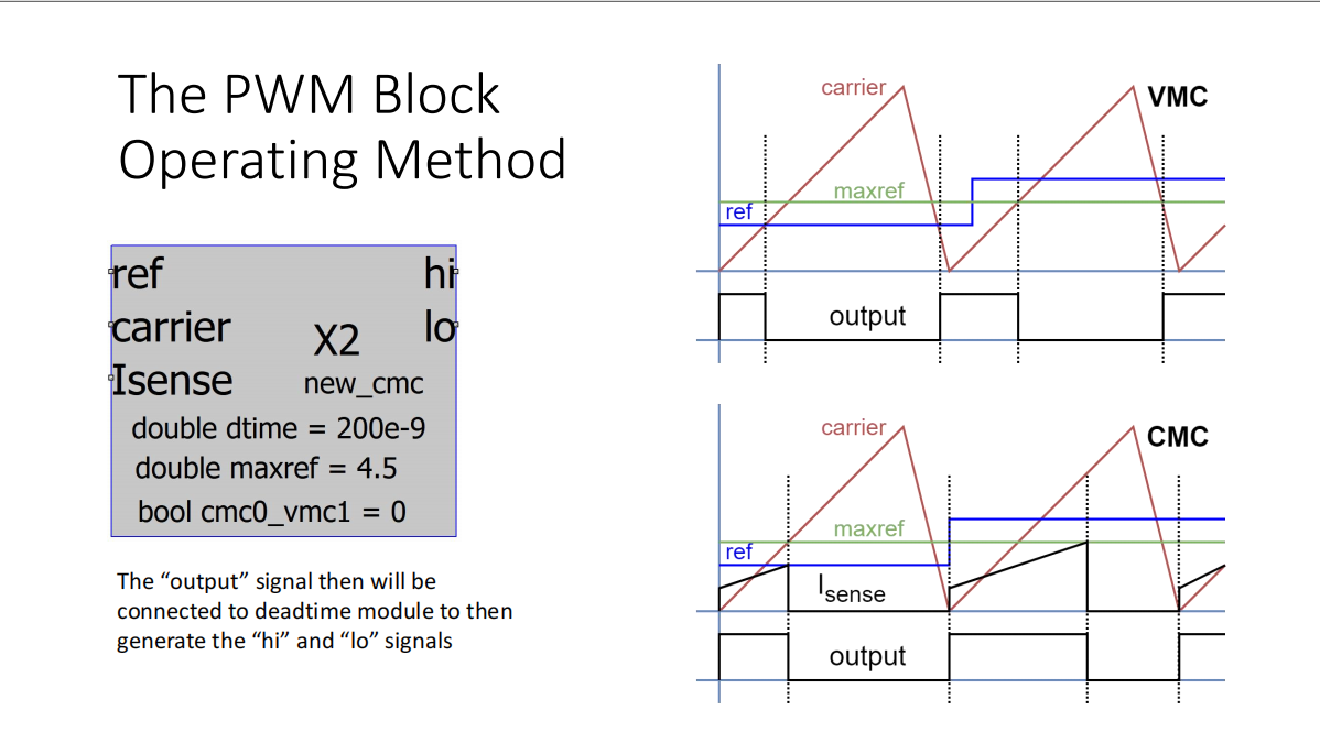

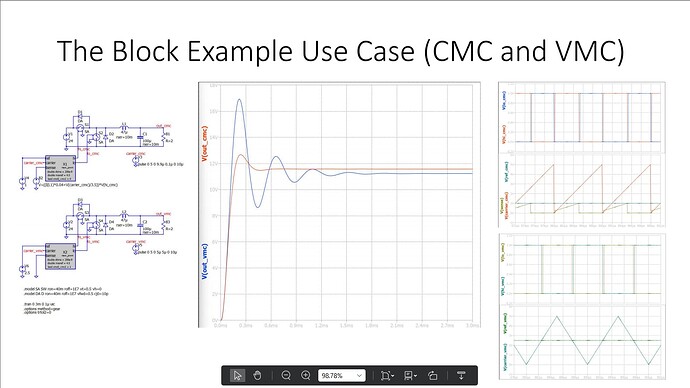

This block supports VMC and CMC operating modes. The output of this block supports single or dual gate signals, with programmable deadtime.
The block is implemented in C-block due to the better timing control compared to the native blocks. This approach can help to significantly minimize the issue I presented in How to remove this wiggle? with less effect on the total simulation time as with another methods suggested
