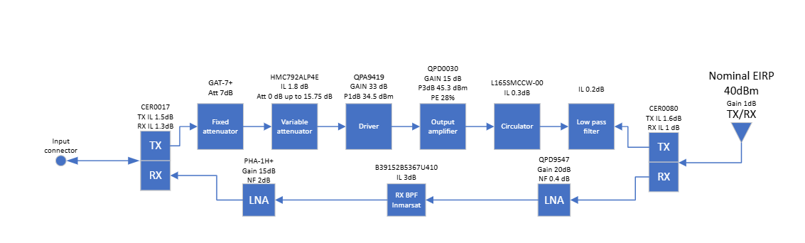

To improve thermal management, our pcb has extra copper layer inside the vias beneath the transistor. A heatsink is permanently exposed to airflow, and the board temperature appears stable after a few minutes of operation. As a driver, I’m using the QPA9419, preceded by a variable attenuator stage as shown in the block diagram. The RF section is isolated from the rest of the circuitry and enclosed in its own box, with the top wall positioned 3.07 mm above the transistor.

Using the QPD0030 in continuous and dissipating 20W you are going to have thermal issues. The device is probably running hot, which is reducing lifetime. The PCB design is going to be critical to get the heat out of the device, as well as the thermal interface between the PCB and heatsink. Qorvo normally uses PCBs with copper coins embedded to minimize PCB thermal resistance. It’s probably easiest to support you going forward via e-mail. Please contact appsupport@qorvo.com with your company name and location and an applications engineer will get back to you.
