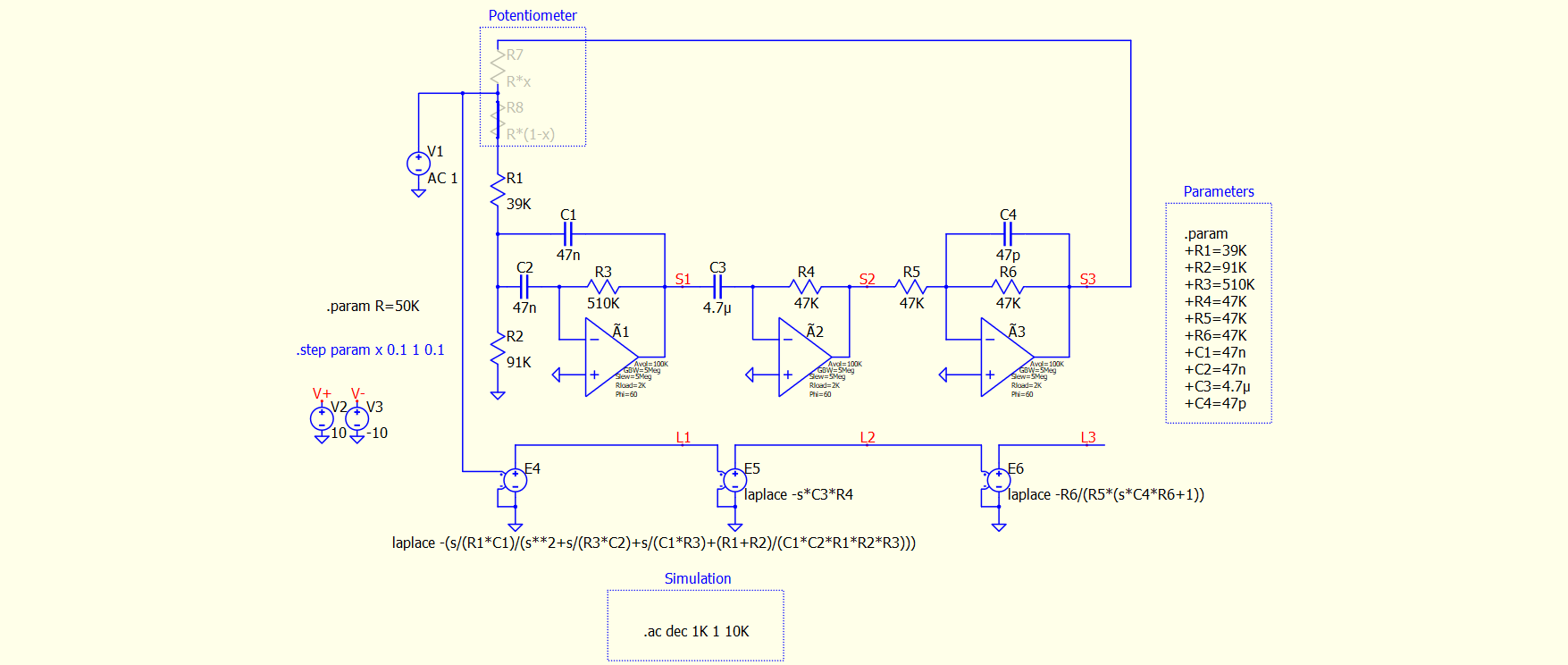

I am new to this. I would like to take a reference circuit of for instance :
And then make the equivalent via analog modelling and then put it on a beaglebone sound processor.

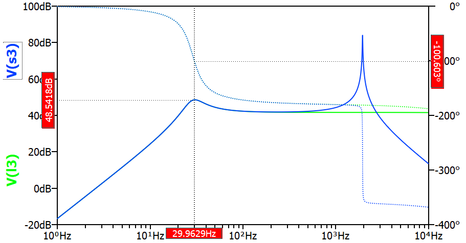

To do this as far as i am aware i need to design the circuit in Qspice , then find the laplace transform.
With this equation i can then export this to make my DSP/C++ code react much like the bands in the EQ would.
Could anyone point me in the right direction to do so?
