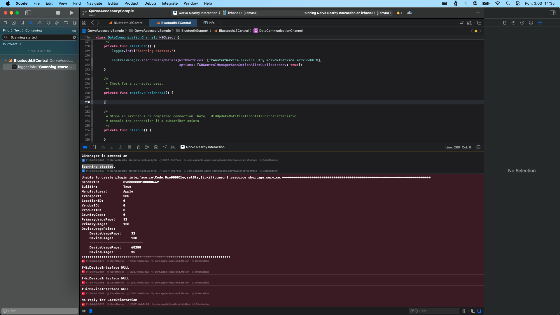

I’ve successfully configured my DWM3001CDK boards with JFlashLite, i auto-calibrated it with QorvoOneTWR. Now i’m trying to see how my iPhone works with those boards. I’ve downloaded Qorvo Nearby Interaction app from AppStore but it is constantly “Scanning for accessories”. I’ve downloaded source code for this app, launched it on my iPhone and it’s still frozen on “scanning…”. I’ve seen it has been mentioned in different threads that i should switch some UUIDs in source code but i do not understand which.
Hi @tomasz.ogrodowski , the firmware running on the DWM3001CDK for using it with the QorvoOneTWR GUI is our UCI firmware from our SDK but you need to change this firmware to our Apple NI firmware if you are intending to connect to it from the iPhone.
Assuming that you have the correct firmware on the CDK, from your picture, if you connect the USB wire to the other port on the board, you can then see the logs using Segger RTT Viewer. Please share those logs to see what might be going on.
