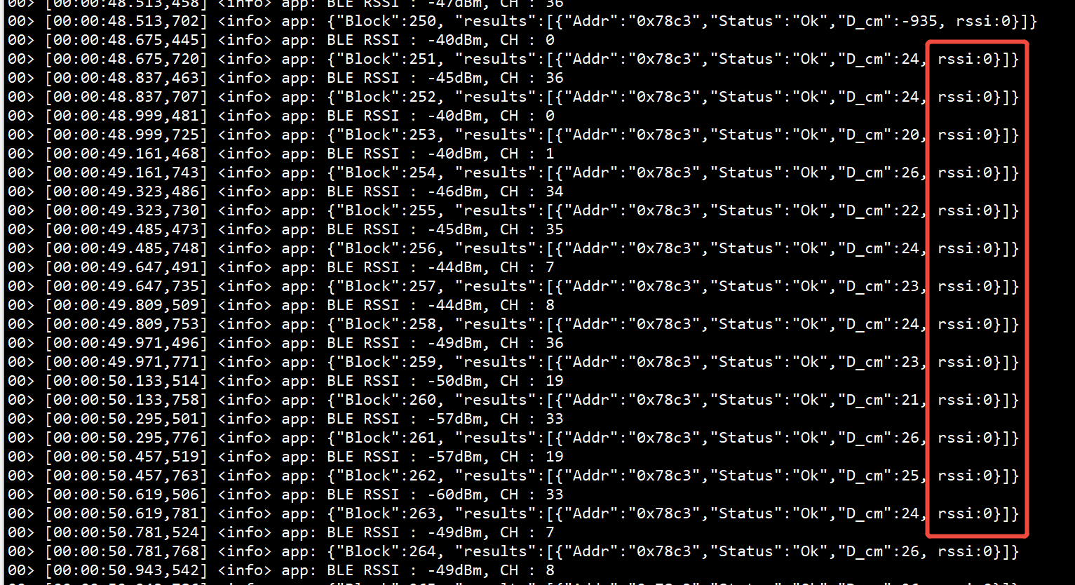

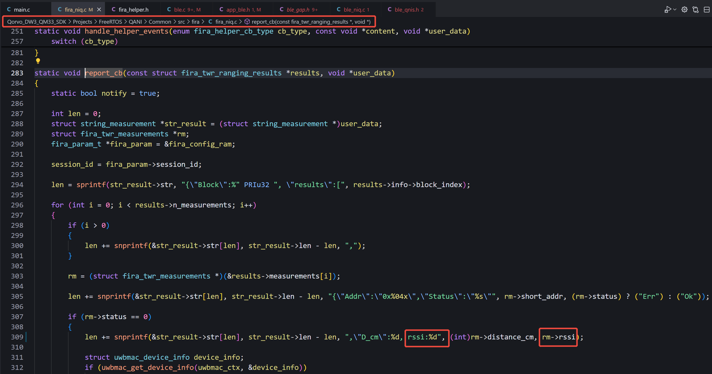

Using DWM3001CDK board to run the QANI routine of the SDK, using iPhone Qorvo NI APP to measure distance. Add uwb rssi print in the report function.
Found that the rssi is always 0.
Is there any way to get the correct UWB RSSI after each fira range?
there is no RSSI on UWB ranging.. there is an actual distance and angles. (I think D_cm in the line)
RSSI is a Bluetooth thing. and is not involved in the UWB ranging.. BLE IS used in the transfer of config info to START the UWB session,
