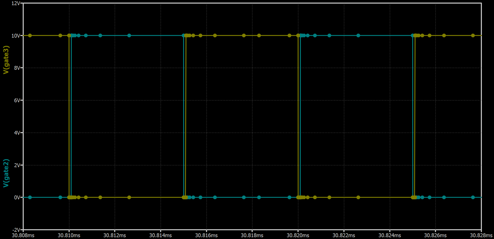

Is there any way to turn off/on the data points on the graphs? Is it possible to not see/to hide those points seen on the graphs?
like this:
Zoom out to get a view that does not have the datapoints.
