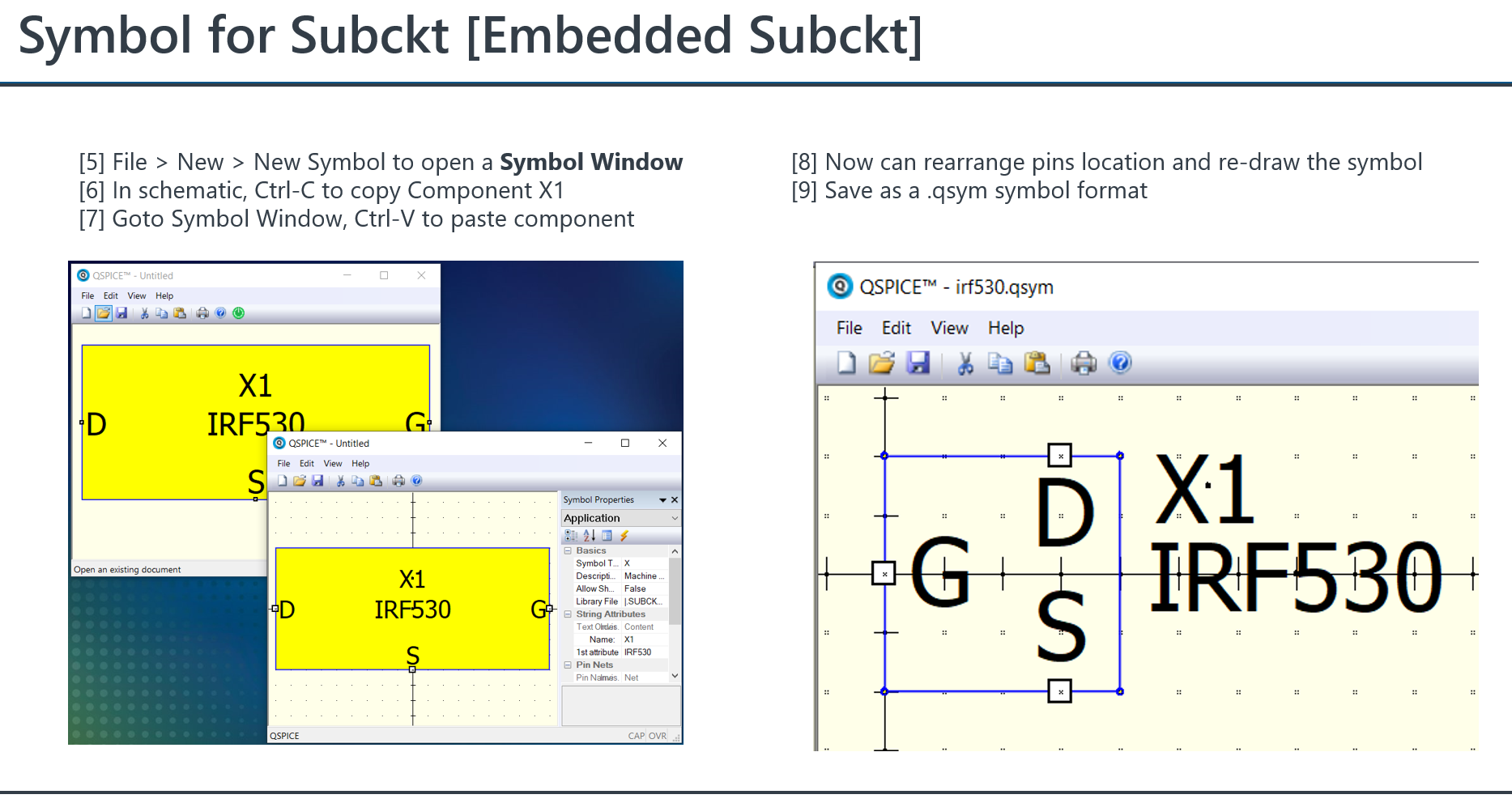

Did you save your symbol as .qsym?
This is an example to convert .subckt netlist to a symbol, and get the symbol from Symbol & IP Browser.
Thank you. That worked. Looks like I needed to save the symbol in the folder.
One thing is that I had to remove the directory and add it again before the part appeared.
