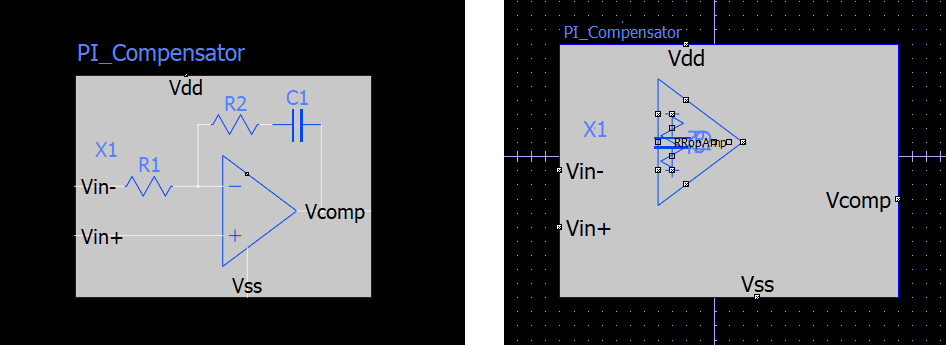

I am creating a new schematic symbol. I would like to draw in components within the symbol. When I copied and pasted the new schematic symbol with the components embedded in the symbol into the new symbol file, they appeared undone.
How can I accomplish this?
Parent.PI_Compensator.qsch (3.4 KB)
PI_Compensator.qsch (4.0 KB)
symbol is a drawing and schematic using wire to connect device.
we have to draw everything in symbol (no wiring in symbol), right click in symbol and those are the thing you have.
by the way, if you copy a device from schematic to symbol, their pin also copied. extra pin will be added into your symbol, thing will mess up.
I think you have my symbol library, open some of them to study how thing can be done.
