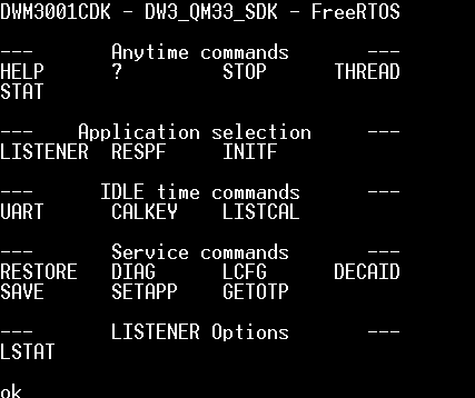

I opened Tera Term and send help command.
When send uart command..

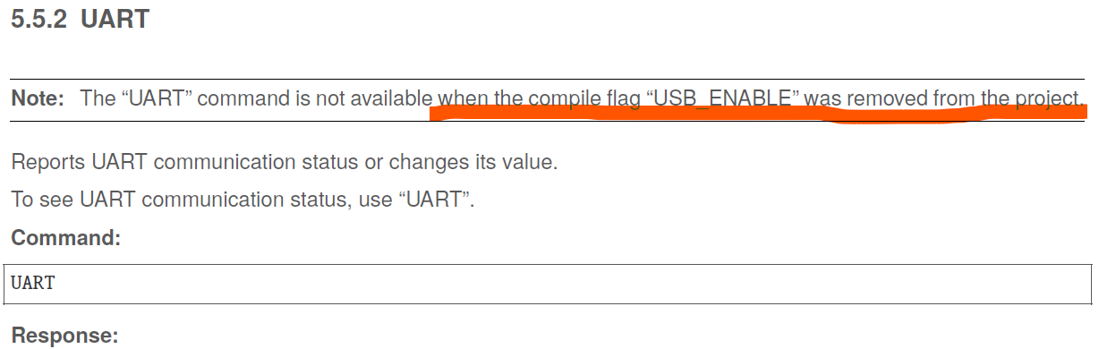

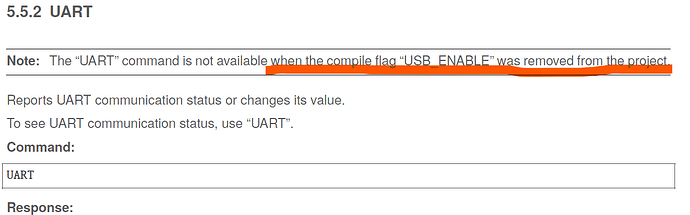

I could not change it to 1. I guess DWM3001CDK-DW3_QM33_SDK_CLI-FreeRTOS.hex does not allow. I read a note in the development manual.
So i could not comunicate with dwm3001cdk modules by uart or spi. So my priority has changed Carlos.
But i did not know how to change this situation?

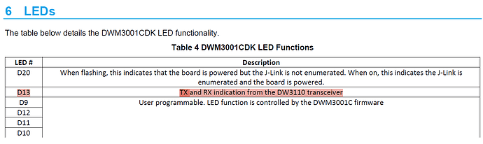

On th dwm3001cdk board, d13 led is always off.
