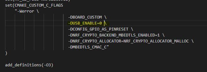

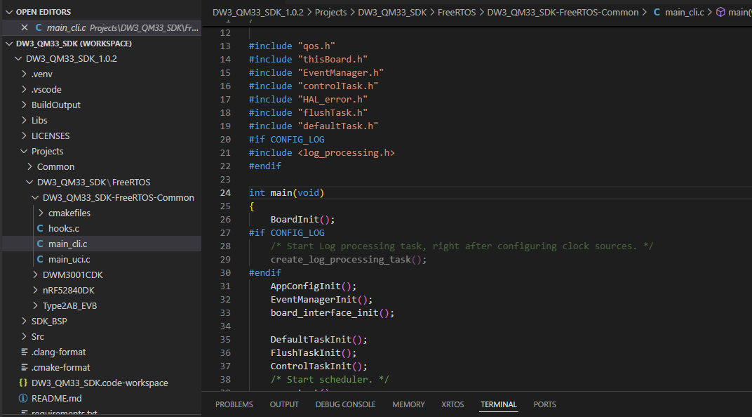

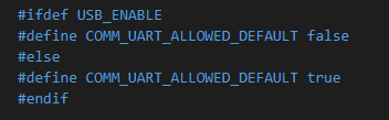

Then i am opening in Visual Studio Code.
Then i found project_common.cmake file and changed to 0.
Finally, i am building project and flashed dwm3001cdk again via jlink. Then i am starting to test.

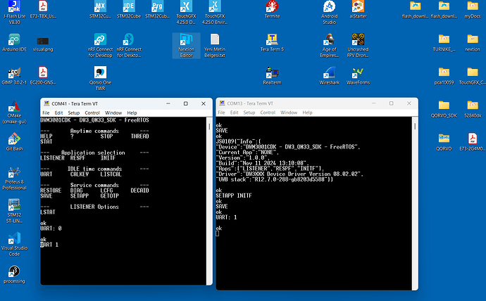

Second SETAPP INITF or SETAPP RESPF. I see response OK. Then Send SAVE. I see the response OK. Then i ask UART.. The response UART:0. Last I send UART 1 then how can i say, dwm3001cdk module is freezing..Could not send SAVE command after this..

This is the expected behavior because once you send UART 1 the communication will be redirected from USB (where your terminal is connected) to the UART. You have to send SAVE from there (UART1).
You’ll have two Teraterm terminals, one connected to the USB (the one you have working now) and another connected to the USB-Serial converter, which will be fisically connected to the DWM3001CDK (header J10, pins 8 and 10 and a GND for reference). When you send the command UART 1 in the USB terminal, the OK response will appear in the UART terminal and the communication will continue there, unless you reset the board. You have to send SAVE in the UART terminal to make it default, so next reboot it will start from UART.

Hi @carlos.silva again..After your last message, I had an enlightenment..:slight_smile:
The smoke cleared and the sun appeared. The incident is clear and everything is ok.
There is no need for a video. As seen below, the process was completed successfully.

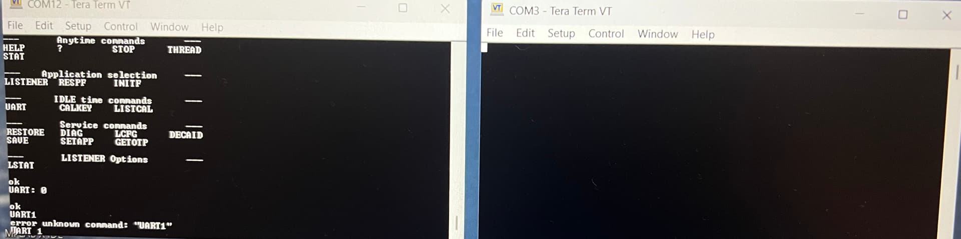

Hi. I did this instruction, but when I sent UART 1 it’s still frozen and the other teraterm terminal which connected to my USB-TTL doesn’t show ok. Do you have any other way to enable the uart?
Hi @Grasyaa ! It should be a straightforward action.
My only suggestion is to double-check the USB-TTL converter and pinouts.
A simple test is to short the TX and RX of the USB-TTL converter. When you type something on the terminal, the chars you type should appear there too.

The other way to enable the UART is to rebuild the CLI project with “USB_ENABLE = 0” in the CLI cmake file, but what you did using the terminal should work just as good.
In other words, if you are having issues with the terminal test, rebuilding with “USB_ENABLE = 0” should have the same issues.

Hi, thanks for your response. I tried what you said but still when I sent UART 1 it’s still froze and when I open the port for USB-TTL it doesn’t receive anything.
Do I need to plug both USB at the same time? Or I will sent first UART 1 and open tera term for USB-TTL?
Is there any chance that you can help me step by step about the connections of the module and the USB-TTL converter?
If it still not working, is there other way to enable uart?
