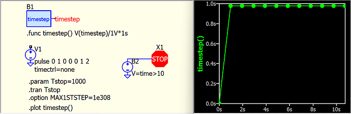

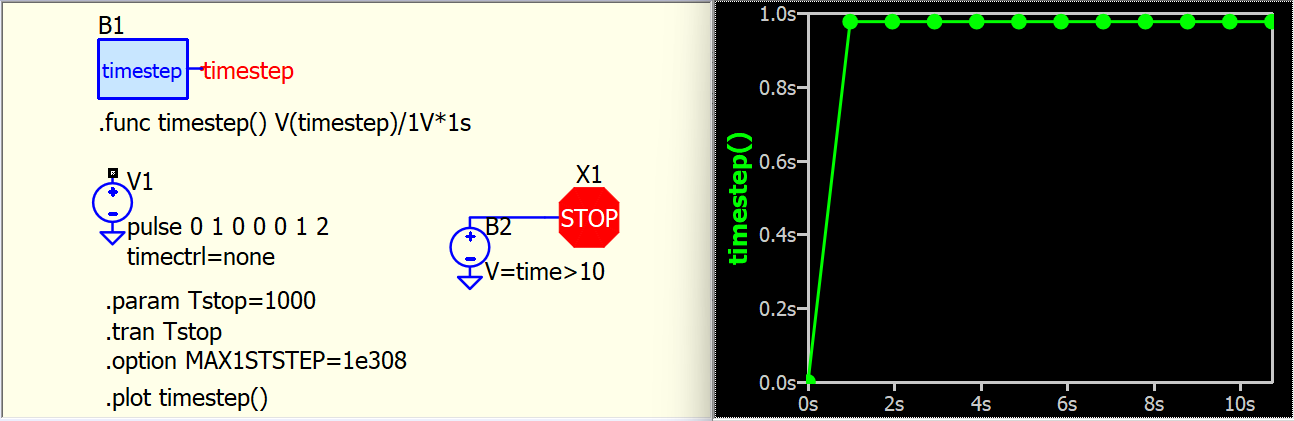

Why do you conclude that the timestep is limited to 2.25ms? For instance, I can provide an extreme example by setting the maxstep to approximately 1s for a 10s simulation.
timestep.qsch (3.3 KB)
There are multiple timestep control parameters; I am just wondering if any of these parameters can help.

Thank you for the example. I think I see where we get different results.
I used your qsch. I got nearly 1s max timestep. (~0.976ms).
Now change .param TSTOP=1000 → .param TSTOP=100
You get a max timestep of 97.6ms.
Change to 10 You get a max timestep of 9.76ms.
Effectively the default max timestep is 0.0976% of the TSTOP value.
My sim was using was a TSTOP of 2.3s. Therefore, 2.3s * 0.000976 = 2.245ms!!! This explains the max timestep I’m seeing.

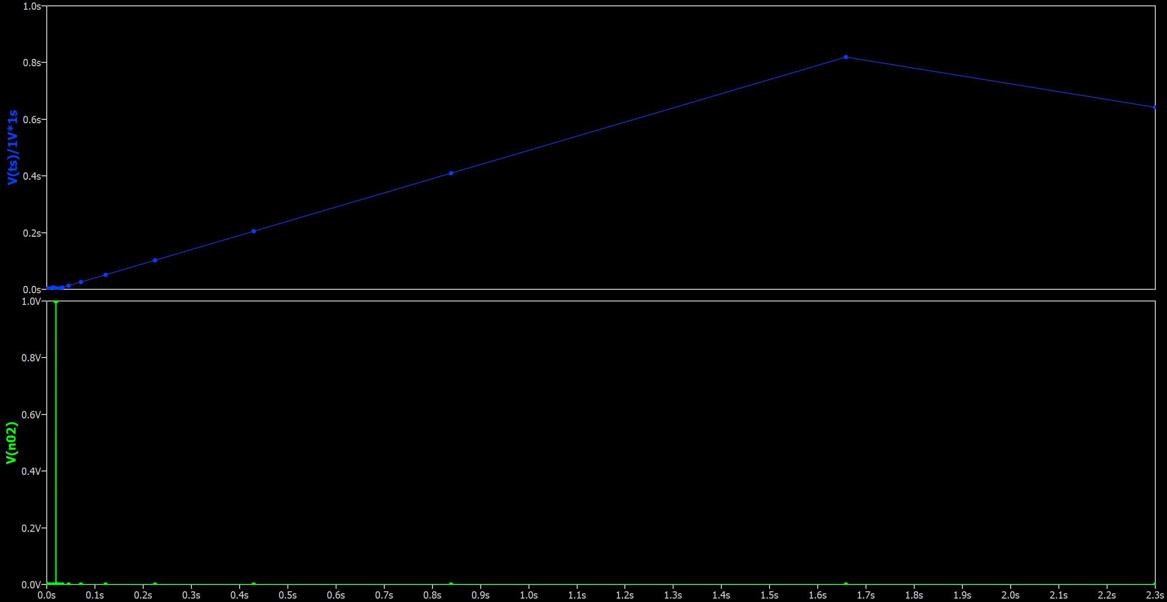

However, if I go to an earlier build (let’s say Nov 11, 2025), I can set a maxstep to 1s and have a TSTOP of 2.3s and I get my 1s maxstep if no events are happening for at least 1.4s.
Here’s a plot using Nov 11 build.
maxstep_test.qsch (3.8 KB)

Oh, thanks for your schematic. I didn’t know that maxstep in .tran could extend beyond maxstep > Tstop/1000. It is uncommon to have a source without timestep control, except for PWL or DC sources, and this may be the reason why I never notice this.
I suppose this behavior was changed by
11/25/2025 Preposterous minimum timestep size stipulations are now trapped.
Do you think the workaround of having a much longer Tstop with an AbortSim() [i.e., STOP symbol] can assist in your simulation work in the latest version of Qspice?
" I didn’t know that maxstep in .tran could extend beyond maxstep > Tstop/1000"
In builds prior to Nov 25: Apparently so.
In Nov 25+ builds, Mike now traps it and ‘ignores’(?) it.
