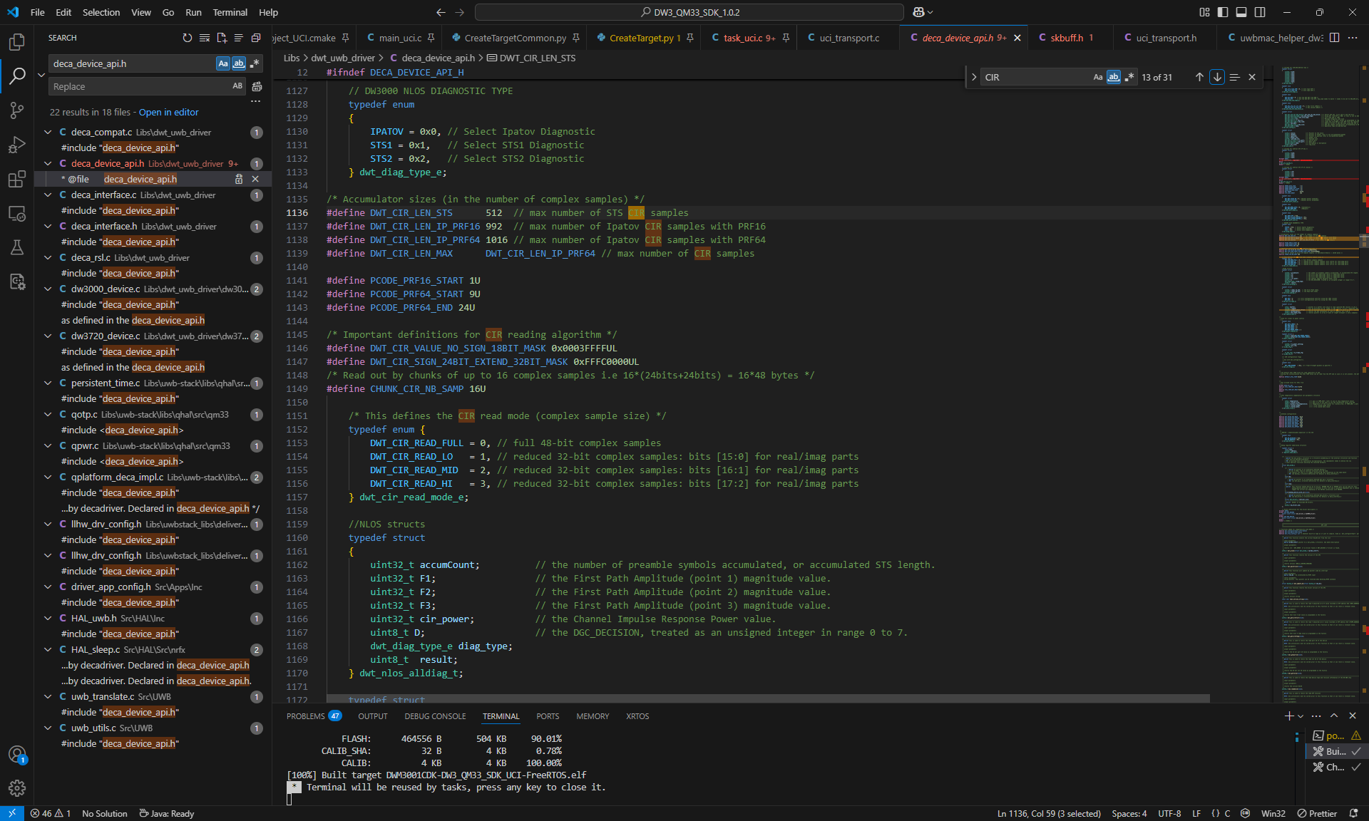

While looking for the place to modify, I found this in “deca_device_api.h”
I just wonder why the “CHUNK_CIR_NB_SAMP” is limited to “16U”
Can I increase this number to get more samples of CIR?
