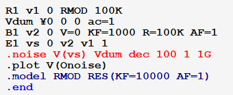

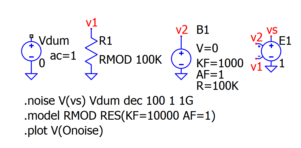

I am trying to generate flicker in a noise analysis with either a resistor or behavioral source using the KF and AF parameters. But only thermal noise shows up in the plot.
Am I missing a statement to correctly enable the flicker noise?

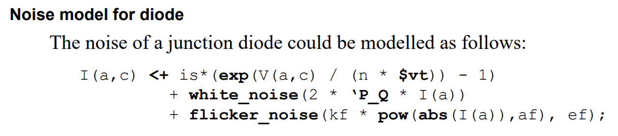

Flicker noise is current-dependent!
However, there was a bug in AF; update to the latest Qspice version to fix it.
