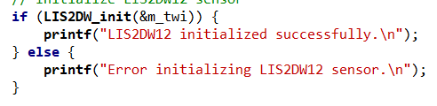

- When I build and load the code, everything is successful and the code is completely done here when debugging. ( jump within this if because the init function returns success )

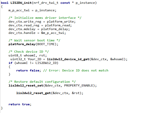

Here, m_twi is the handle of i2c that has been init above. Inside this LIS2DW_init function do the following:

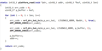

When the debug pointer jumps inside the device_id_get function, what I want is that after executing this function, the whoamI variable must return the same value as LIS2DW12_ID. When this is considered a successful execution, but after executing this function, whoamI always returns the value 1, resulting in a false return.
On the inside of the device_id_get function, simply start i2c communication with the sensor through an interrupt function like this:

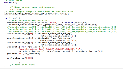

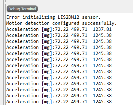

After the i2c transmission is complete, whoamI returns the value 1 and this results in the device not being initialized successfully. Although not initialized successfully, the underlying communication functions still run through ? And at the end when reading the sensor value, when printed, it continuously returns an unknown value.
