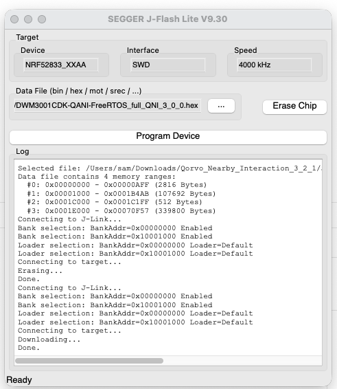

here is the jflash page after flashing
@rexxdad , try to click “Erase Chip” in J-Flash Lite before doing “Program Device” to see if that fixes it.
no that did not change the outcome.. I should have mentioned that on last post.
