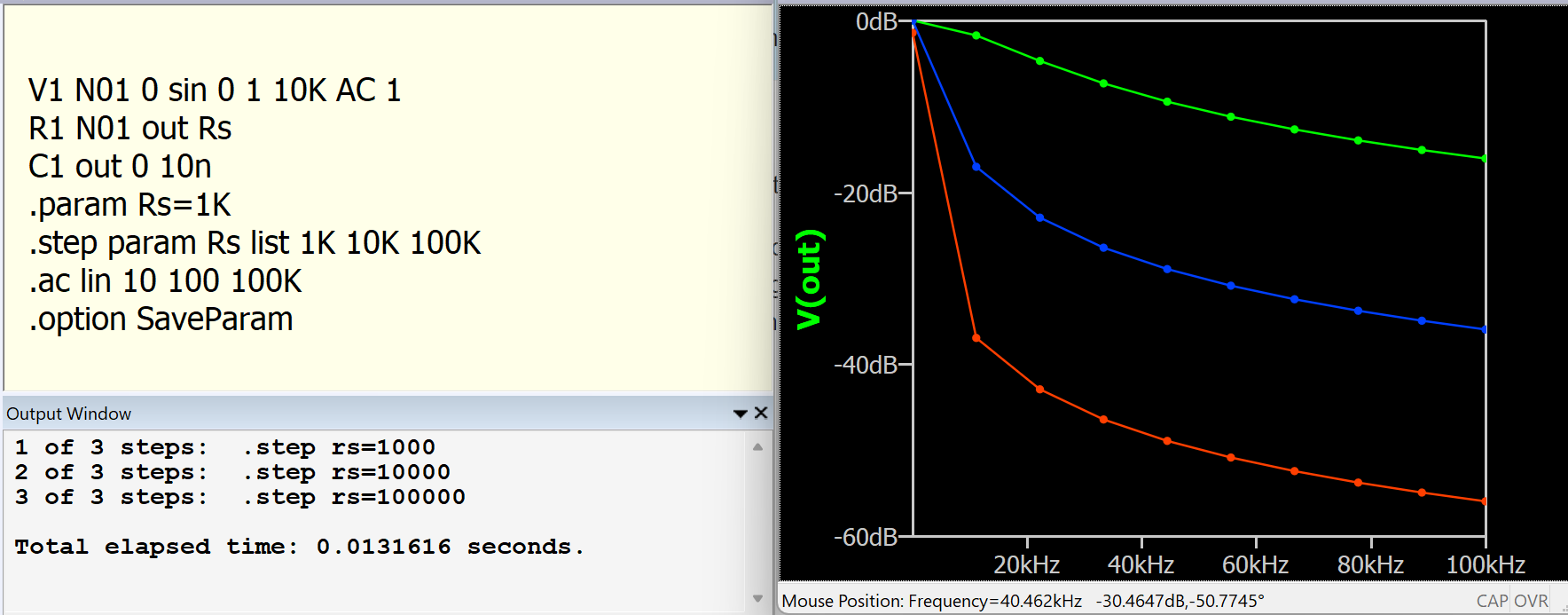

Run your netlist, but no errors are returned. Are you running the latest version of Qspice?
Yes, I run into this issue on another computer with an older Version. Then I updated but same thing. To report the issue I used my laptop, updated QSPICE and generated the netlist from schematic. Same thing on the second computer.
From your response I now gave it a try with just the netlist pasted into the schematic window, again with the same result.
See the attached picture.

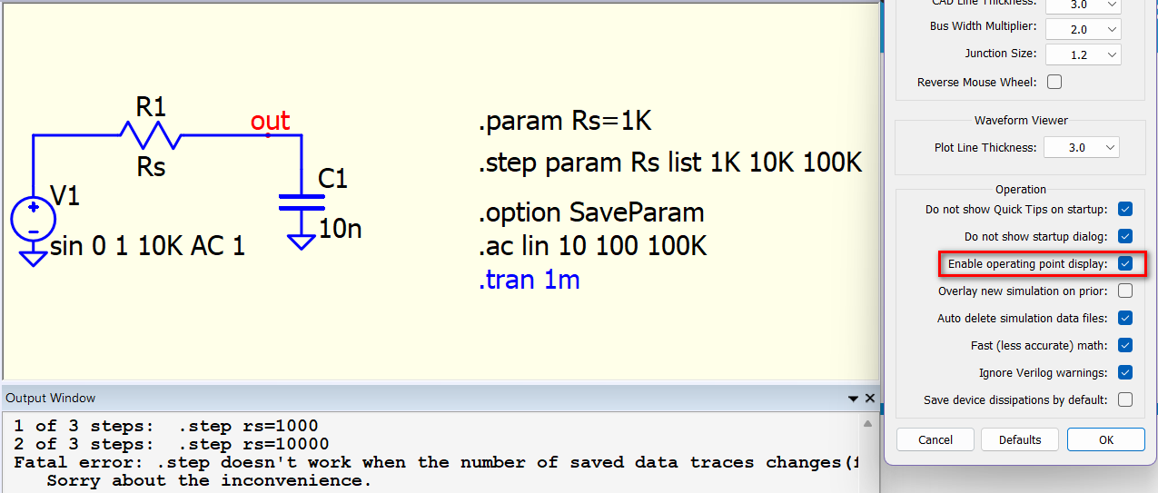

Ok… here is where the simulation failed.
I usually disable the operating point display, so I did not replicate this in the morning.
