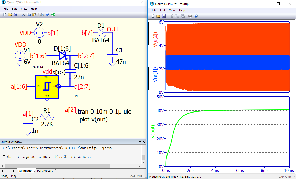

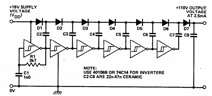

Hi guys. I am attempting to simulate a Schmitt-Trigger using the SN74HC14 inverter chip. It is a boast converter, changing 6V to 60+ volts. Here is basic schematic.

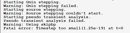

Here is a screenshot of my error message.

I am assuming the problem is in the model. Any help would be appreciated, thanks guys.
