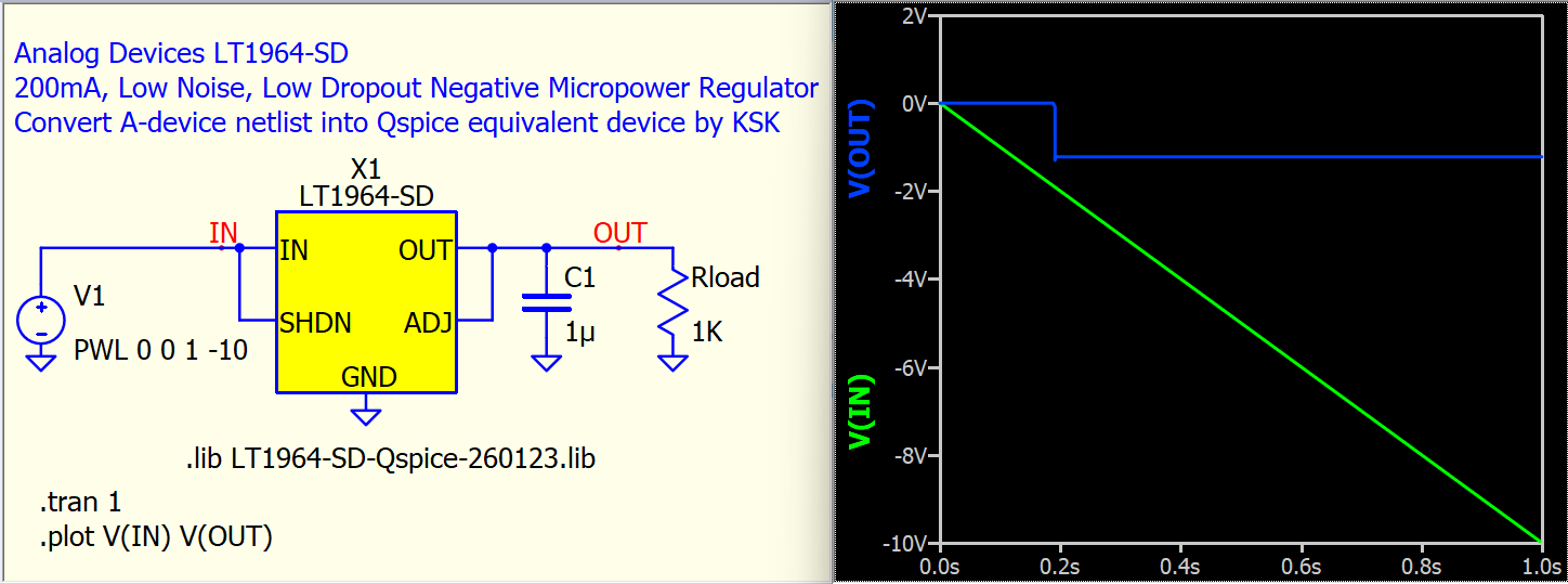

For hobbyist purposes, here is my conversion of the A-device to the Qspice equivalent device for the LT1964-SD. I have put in significant effort to study how to obtain an equivalent A-device, and currently, I am developing a MATLAB code to facilitate the .subckt netlist conversion process. If you notice any errors in this conversion, please feel free to point them out.
example.LT1964-SD.qsch (3.5 KB)
LT1964-SD-Qspice-260123.lib (1.8 KB)
