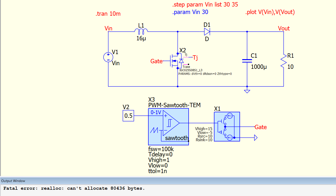

When I created an Infineon device model and ran a simulation, I got the message “Fatal error: realloc: can’t allocate xxx bytes.”
By the way, this error doesn’t appear unless I’m running a step simulation, but it occurs when I run a simulation using the step command.
Could someone give me some advice?

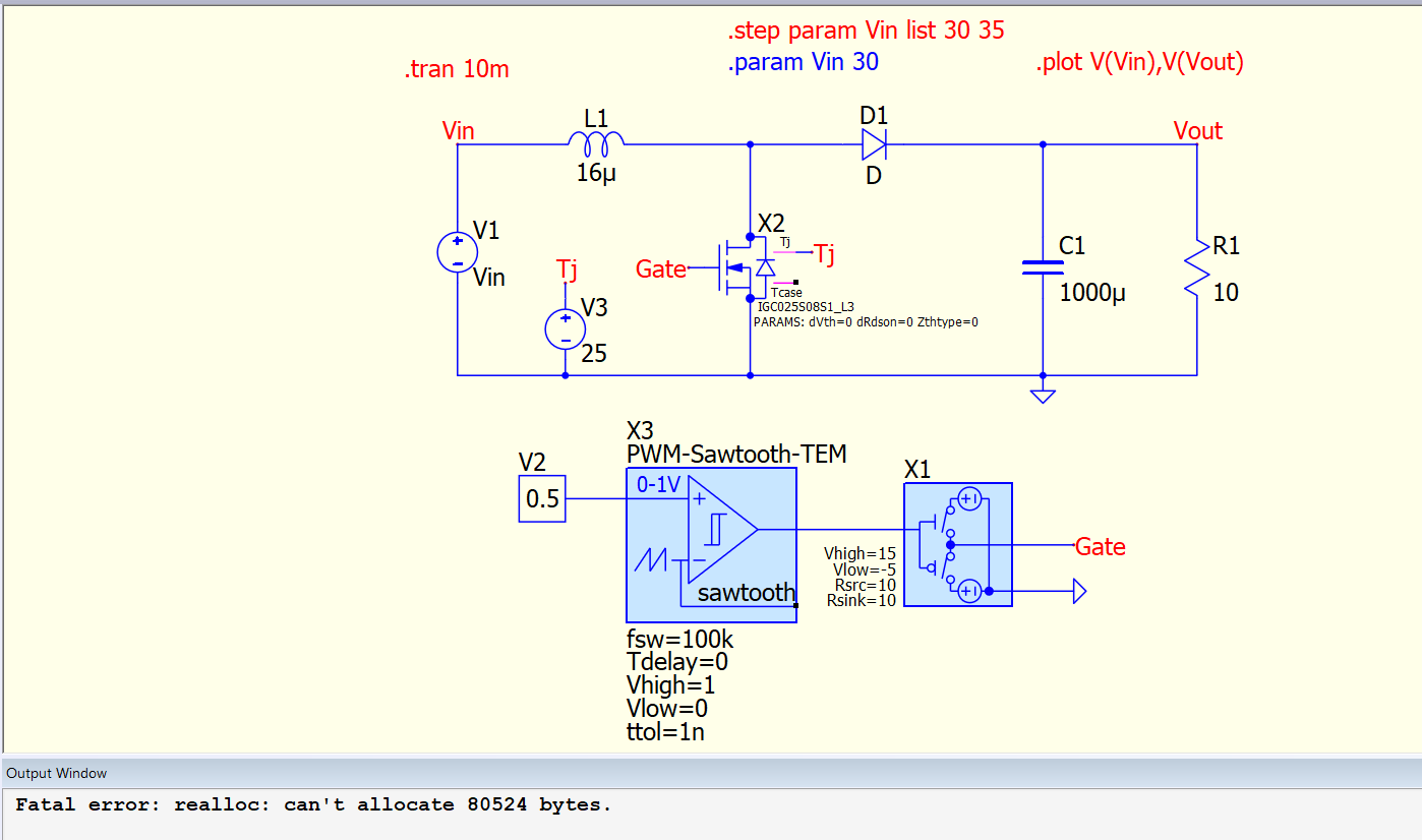

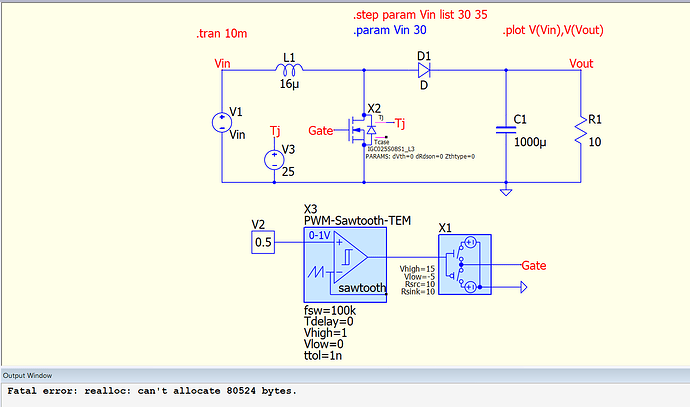

I get the same error even after adding Tj
I suppose the issue might be related to X2? Well… in general, you need to assign a voltage source (25V) to Tcase to set the case temperature but not the junction temperature. But just guessing, the best is that you can upload your schematic.

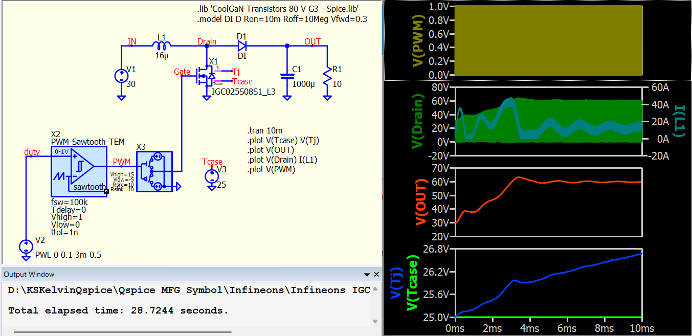

I was able to run this simulation without encountering the fatal error. The model was downloaded from Infineon, and I modified the duty cycle from a fixed 0.5 to a ramping duty cycle to reduce simulation length as prevent significant current overshoot at startup.
example.IGC025S08S1.qsch (13.0 KB)
CoolGaN Transistors 80 V G3 - Spice.lib (9.5 KB)

Oh, it weird that .step currently stopped working in this schematic. Let me report that to Mike. I didn’t pay attention you particular indicated this schematic not working in .step. Sorry for that.
Possibly, Mike will provide a permanent solution later. In the meantime, use this modified library to resolve the stack space issue when .step is used with this model.
The change involves removing +0 from a parameter, replacing dVth={dVth+0} with dVth={dVth}.
CoolGaN Transistors 80 V G3 - Spice - TempSolution.lib (9.5 KB)
Update Qspice, and this issue is resolved. The original library can now be run with .step.
