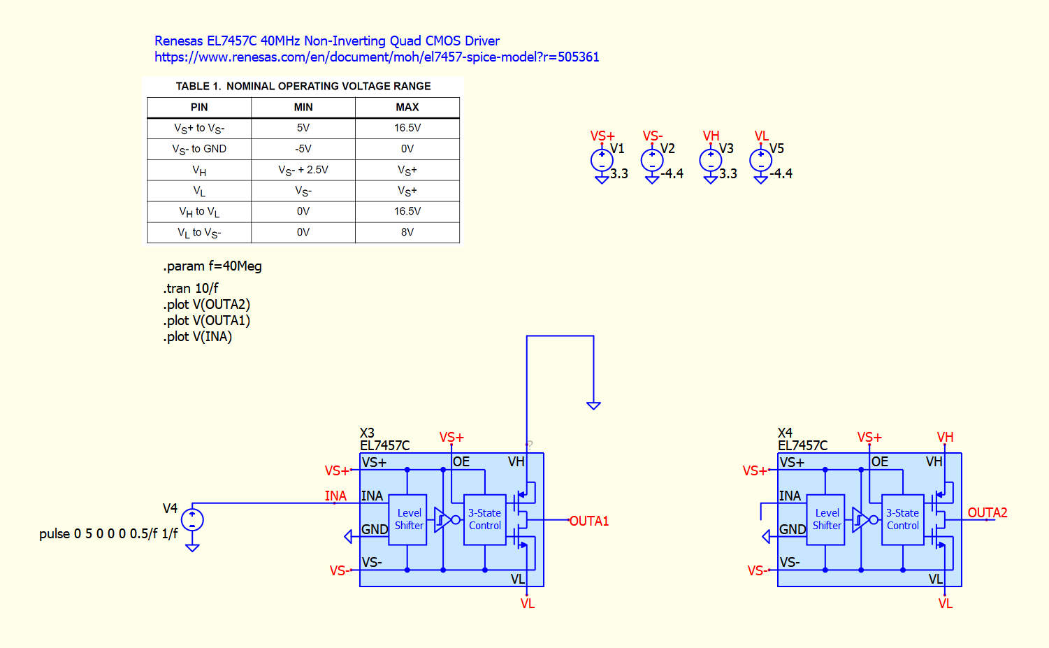

EL7457 model bug? or missing parasitics needed?
Context:

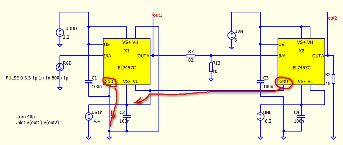

I am in the process of designing a PCB which contains a 2-stage CMOS driver subcircuit.
I picked up the same subcircuit from an existing design with the intention of tweaking some of the passive components. This subcircuit (in the attached KiCad schematic) actually works (on the physical PCB) as I was able to verify using the test points.

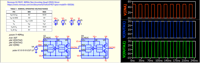

Simulation Behavior:

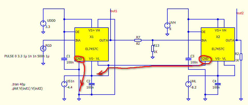

I am trying to simulate this in QSPICE in the QSPICE schematic (cannot attach since I am new user, please help). It seems that without connecting a resistive load there is no pulse on the output of the EL7457. I can live with that at the output of the 2nd stage. However, with regard for the 1st stage, I would rather have all the components connected to the trace between its output and the input of the 2nd stage match what is going on with the actual design (no extra resistive load) with an inclusion of parasitics that is still practical. The problem: X2.INA is not behaving as a resistive so there is no pulse at X1.OUTA.
Workaround attempts:
  • I tried some solutions that model the trace parasitics as transmission lines. The problem is that when the transmission line is terminated correctly (case of T1) it works as a voltage divider. Also why should I assume that these terminations actually reflect the input and output impedances of the ICs. For these reasons (and perhaps others) I don’t feel that a transmission line modeling of the parasitics makes sense. Please correct me if I am wrong and you have the time and patience.
  • Aside from that I can use a simple resistor connected to the trace and to GND, but why should I do this when I know that I am drawing current through it and this does not reflect actual parasitics.
Please let me know what I am doing wrong in QSPICE?

Thanks @RDunn,
In accordance with the forum entry you referred to, I uploaded the code of the schematic.
Note that the embedded EL7457 symbol in the schematic is translated from the SPICE symbol provided by RENESAS.

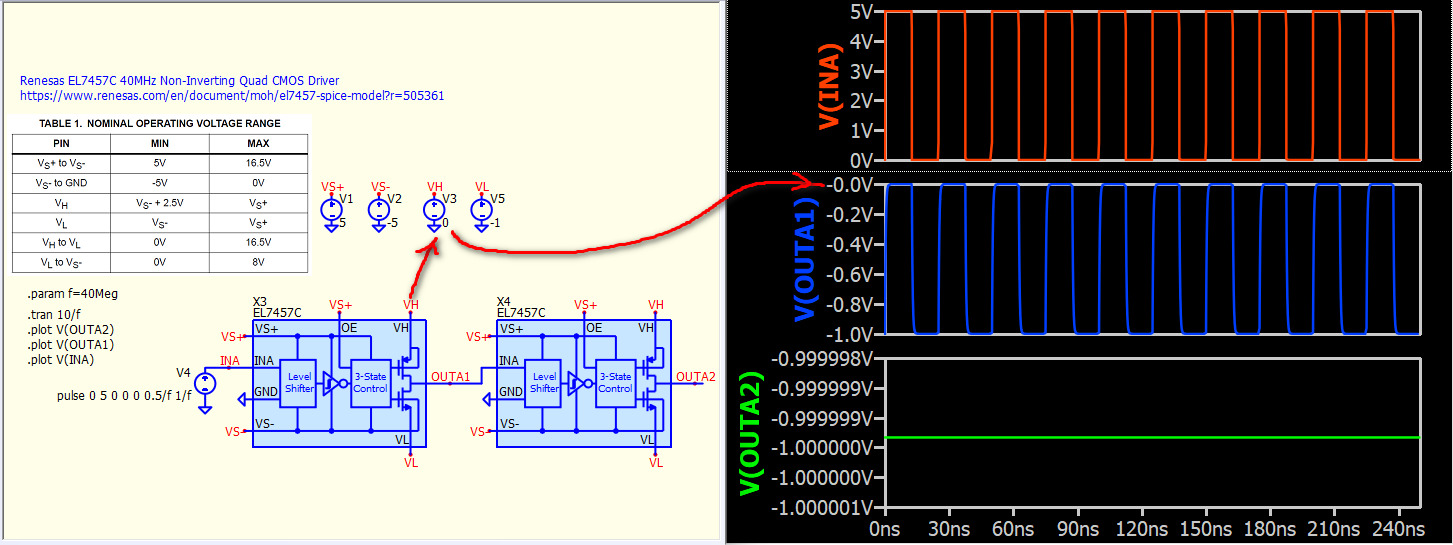

Are you referring to model download from EL7457 - 40MHz Non-Inverting Quad CMOS Driver | Renesas
This is simulation result from Renesas EL7457C SPICE model, but series resistor between symbols is not required.
example.EL7457C.CMOS-Driver.qsch (40.6 KB)
Renesas-EL7457C.qsym (3.8 KB)

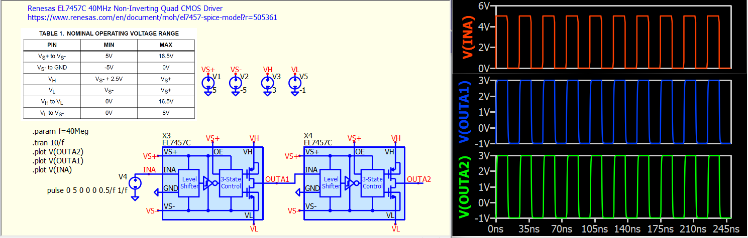

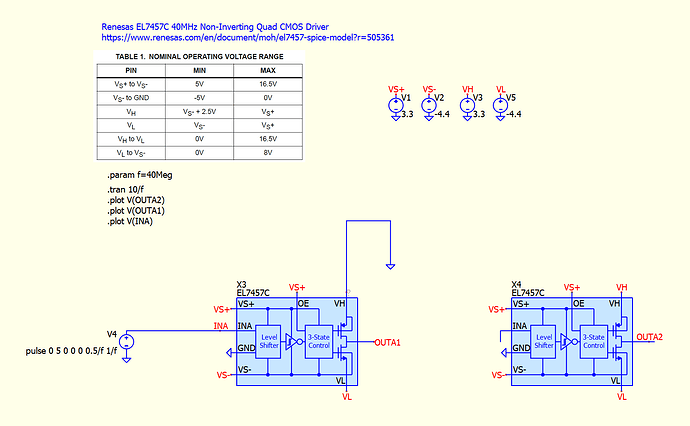

Thanks @KSKelvin,
Yes, we are using the same model. I used Mike’s explanation in the youtube video to generate mine from the symbol that I downloaded from the same RENESAS webpage you refer to. I think you added a drawing from the datasheet which makes the symbol look nicer in the schematic. I am a beginner so I am only trying to get my subcircuits to function in QSPICE.
I ran your configuration and I can see that it works.
However you have configured the circuit differently compared to the .qsch which I uploaded.
I slightly adjusted your schematic just to change the voltage levels on the 1st stage to match my subcircuit and now it no longer works again (I detached the 2nd stage since clearly the problem is in the configuration of the single IC). Why is that? The levels are all still within the limits in the table (I checked the datasheet before asking of course.)

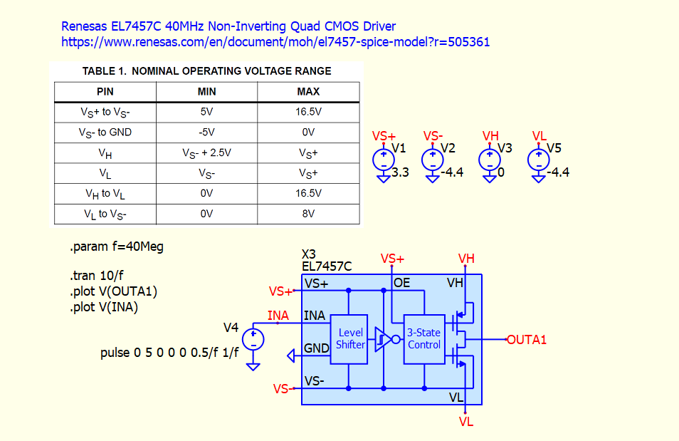

The schematic you shown with first stage VH to GND, OUTA high level is 0V? And second stage has nothing connect to VIN. Is this screen capture correct?
Hi @KSKelvin,
Yes this is intentional. I want VH for 1st stage to be 0V. I just disconnected the 2nd stage to observe what is going on with the 1st stage only.
If VH=0V, OUTA1 high level is 0V. This looks normal.

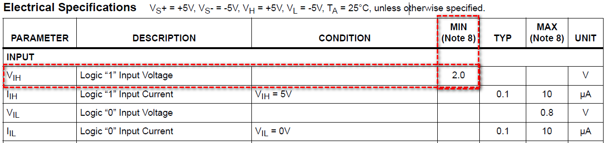

You know that INA (or VIN) must be larger than 2V as logic HIGH for input, right?
In your uploaded schematic, the GND of the second stage is connected to -4.4V. It is possible that the model from Renesas does not account for this operating condition. Is this your physical connection, and does it actually work?
Simulation model may not cover connections that fall outside its intended use. In general, the GND pins would generally be expected to be connected together to same the same ground or same floating ground.
Hi @KSKelvin,
Yes, I read the parts of the datasheet which you are referring to.
I am assuming that you’re pointing out that VIH_min = 2V, because in my original schematic the VIH_min=0V for the 2nd stage.
As you can see, in my original schematic, the GND pin of the 2nd stage EL7457 is tied to US1n = -4.4V. If this is problematic let me know. But if it is not, then the INA pin of the 2nd stage EL7457 is seeing a signal that ranges between 0V and 4.4V relative to its GND pin.

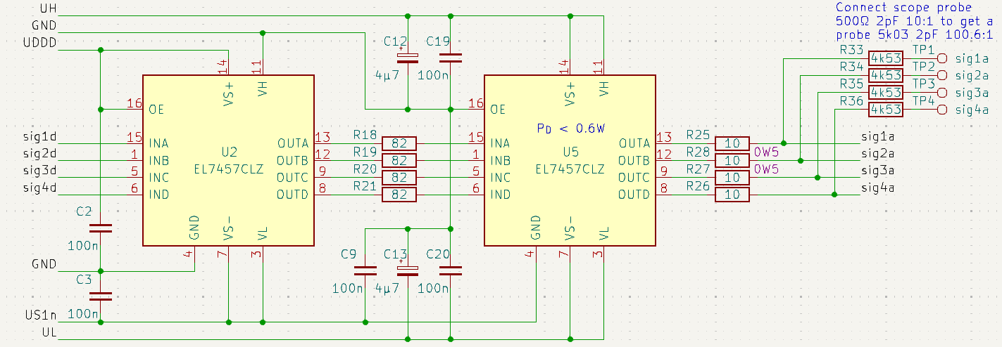

https://forum.qorvo.com/uploads/default/original/2X/6/6f01f3ebf36587aeca70eb077efbe15b1de756a0.png
Yes, I mentioned this in my original post.

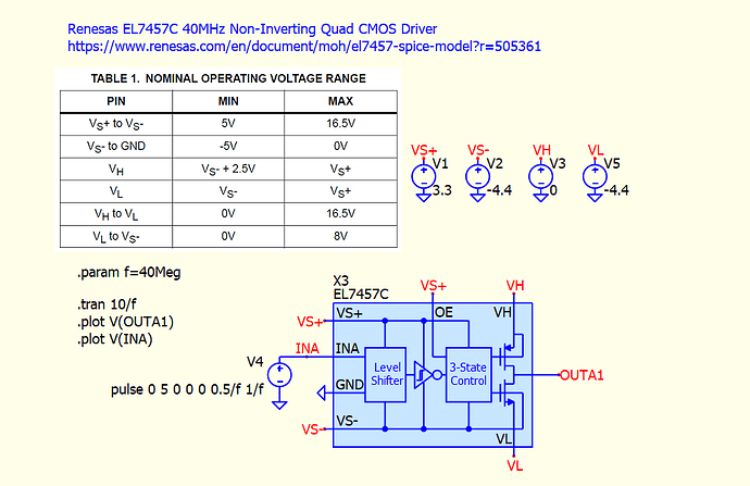

Again, I will just use the 1st stage of the 1st schematic which you uploaded to demonstrate that I am not even getting correct behavior from the output of the 1st stage (using my design’s configuration).
The configuration I am using here is valid according to Table 1 and the electrical specifications. If not please correct me one last time.
Other than that it just appears that this model does not allow the ranges specified in the datasheet.
