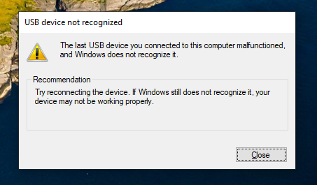

I’m quite new to all of this. I have DWM3001CDK, I downloaded SDK v 1.0.2 and flashed the UCI binary (DWM3001CDK-DW3_QM33_SDK_UCI-FreeRTOS). I wanted to test the provided scripts, but after flashing and connecting the board to computer via J20, my PC can’t see the COMx for communication, therefore i can’t run scripts. Windows is giving me this error and i do not know if i need some drivers or what should I do to make it work. While using CLI firmware I can see the board connected as COM4 and communication works (except the scripts which give me “No response from the device (timeout)” obviously)

Do you see any COM port when loading 1.0.2 UCI firmware and connecting a USB cable to J20? Can you share a screenshot of your device manager?
Hey, i just wanted to send you a screenshot. So i erased firmware and flashed it again and now it miraculously works. Could there be a problem when using Linux and/or Windows for flashing? I normally work on Linux but now I’ve done the whole process on Windows (downloading firmware, flashing it) and it just works. Thank you so much for your help!
Glad it is working again! Normally there shouldn’t be an issue between using Linux or Windows for flashing but perhaps there was an issue in the flashing process when you first did it.
