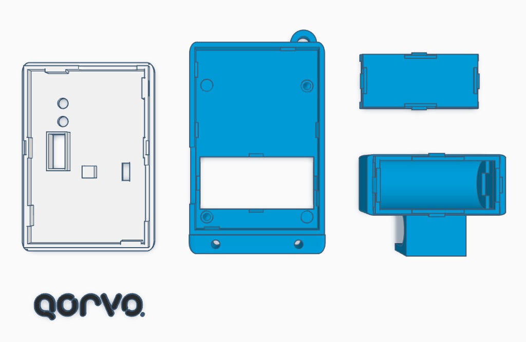

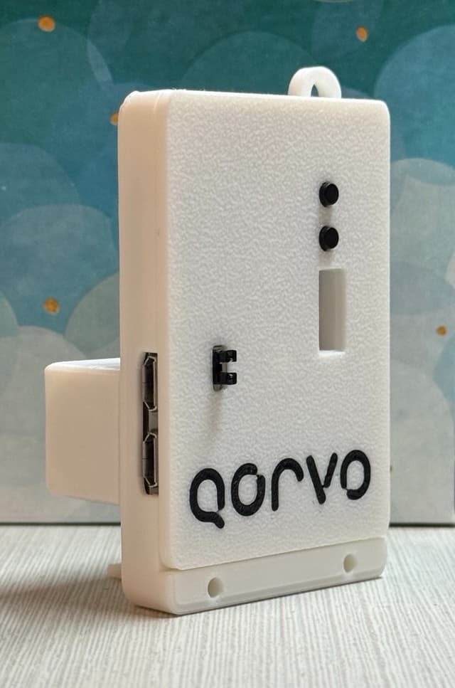

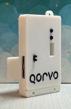

Sharing the custom enclosure design I created for the Qorvo DWM3001CDK.
Click here to download
Design Highlights
  • Fits the DWM3001CDK with conical locators to keep the EVK securely positioned
  • Cut‑outs for USB ports, push buttons, LEDs, and jumper
  • Includes both a battery holder and an optional cover plate to support multiple use cases
  • Bottom mounting provision for a 1/4" tripod screw
  • Lanyard attachment point at the top‑right corner
  • Interlocking clip design allows the enclosure halves to assemble easily and securely
Build Plate Preview

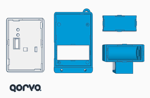

Hey there. Thank you so much for sharing your design for free. One thing I can’t be sure about is if the battery holder part is to enclose a battery case itself (like this one: CR123A Battery Holder) or to just place the metal parts that contacts with the battery? I would really appreicate if you could clear out that part.
Hi @AlperShal
The battery holder part is designed to hold the battery metal contact plate inserts and also the battery. There is a dedicated space on either side of the holder to fit the metal plates soldered to a JST connector.
