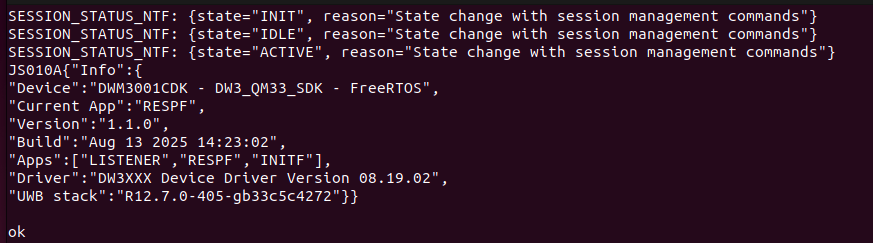

connect.. I see the init, idle and active status, but nothing else.
menu stil active

if I set initf mode, save, and recycle power, connect via terminal, I see
not enough memory
