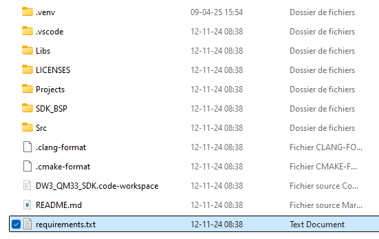

Where is “requirements.txt” or where does it come from? It’s not installed anywhere.
It is provided in the project folder. If you don’t have it, perhaps you don’t use the right project ?
