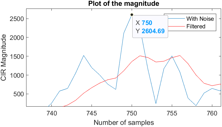

The theoretically ideal CIR would be an impulse response, a single high value with all other values 0.
Obviously you’ll never get the theoretical result in the real world but if you look at the CIR in the middle of a field with the antennas several meters above the ground you can actually get fairly close to it.
The highest peak is simply the strongest signal. The direct signal is always the first peak. By definition reflections have traveled further than the direct signal which means they will arrive later.
In your second picture the first peak is the direct signal, the second peak ~15 samples later would represent a reflection that arrived at the receiver around 8 ns later (From memory it’s ~0.5ns per sample). This implies a reflection path that is around 2.5 m longer than the direct path (c = 30 cm per ns, 8*0.3 = 2.4 m).
In a NLOS situation it depends what the obstruction is. If it’s a solid metal sheet then the signal is completely blocked and no direct signal will be seen. If it’s something like wood then the direct signal will be attenuated but still detected. This will give a far smaller first peak often a lot smaller than the reflections. But as long as the first peak is above the detection threshold then you can still range based on it.
The first peak will normally still be around index 740.
So basically it is normal that if i did a NLOS experiment with a person as obstruction the first pick is:
In your second picture the first peak is the direct signal, the second peak ~15 samples later would represent a reflection that arrived at the receiver around 8 ns later (From memory it’s ~0.5ns per sample). This implies a reflection path that is around 2.5 m longer than the direct path (c = 30 cm per ns, 80.3 = 2.4 m).
How do you manage this calculation, cause i didn’t found anything in the Development guide.
Also what does implies "This implies a reflection path that is around 2.5 m longer than the direct path (c = 30 cm per ns, 80.3 = 2.4 m)."?
I made another experiment with wood between the boards, which are placed at 3 m of distance.
You could get that. An obstruction will generally reduce the ramp rate at the start of the pulse and decrease the direct path peak. But beyond that the effects are very variable depending on exactly what’s going on. It may end up looking like the first peak has been spread out.
Despite what all the diagrams and simple explanations say you don’t have a direct signal and a single reflection. You have a direct signal and hundreds or thousands of reflected / refracted signals all mixed together.
If the second peak is 15 samples behind the first peak then it arrived 7.5 ns later. (I’m eyeballing the chart, it looks to be around that, maybe a 16 samples)
Since it’s the same signal traveling between the same antennas that delay must be due to it traveling a longer distance.
Distance = Speed * time = 3e8 * 7.5e-9 = 2.25
So the second peak traveled 2.25 meters further.
For a strong reflection the simplest cause is a wall behind or to the side of the antennas. If it’s behind then it’s going to be half the extra delay away. If it’s to the side then you can use Pythagoras to calculate the distance the wall would need to be based on the antenna separation. You will also get a reflection off the ground but unless you’re very high that path is normally going to add less than 2 meters of extra distance so I discounted that.
On your second image in the latest post the direct signal is certainly that first peak. If I had to make a guess I’d say the direct signal through the wood arrived at 741. The peak at 744 is the direct signal bouncing off the ceiling and bypassing the wood that way, the signal at 750 has bounced off the wall and gone around the wood.
Is the ceiling about 1.3 meters above your antennas?
744-741 = 3 samples = ~1m of extra path so 4m rather than 3.
Looking at the path from the antenna to the reflection source: sqrt(1.3^2 + 1.5^2) = 2
So a surface 1.3 meters to the side, above or below your antennas would provide a path that would cause a reflection about 3 samples after the direct path.
I’m not sure what the point of plotting a low pass filtered version of the CIR is.
Hi Andy sorry for the delay, anyway i did a more precise experiments, similar to the previous one, so basically i have wood as obstruction.
the two boards are 3 m (measured) from each other and the antennas are about 240cm from the ceiling, while the “wood obstruction” is in t
he middle and higher than where the boards are located.
Looking at the path from the antenna to the reflection source: sqrt(1.3^2 + 1.5^2) = 2. What 1.5 is reffered to? and what does implies that i have 1 more meter of extra path? DO you think that is consistent as result?

I’m only considering half the path and assuming things are symmetrical around that. If the antennas are 3 m apart and the signal is reflecting off a surface that is roughly parallel to the antenna to antenna path then the signal is reflecting off that surface at a distance of 3/2 meters away in the direction between the antennas plus the antenna to surface distance away in the direction orthogonal to that.
