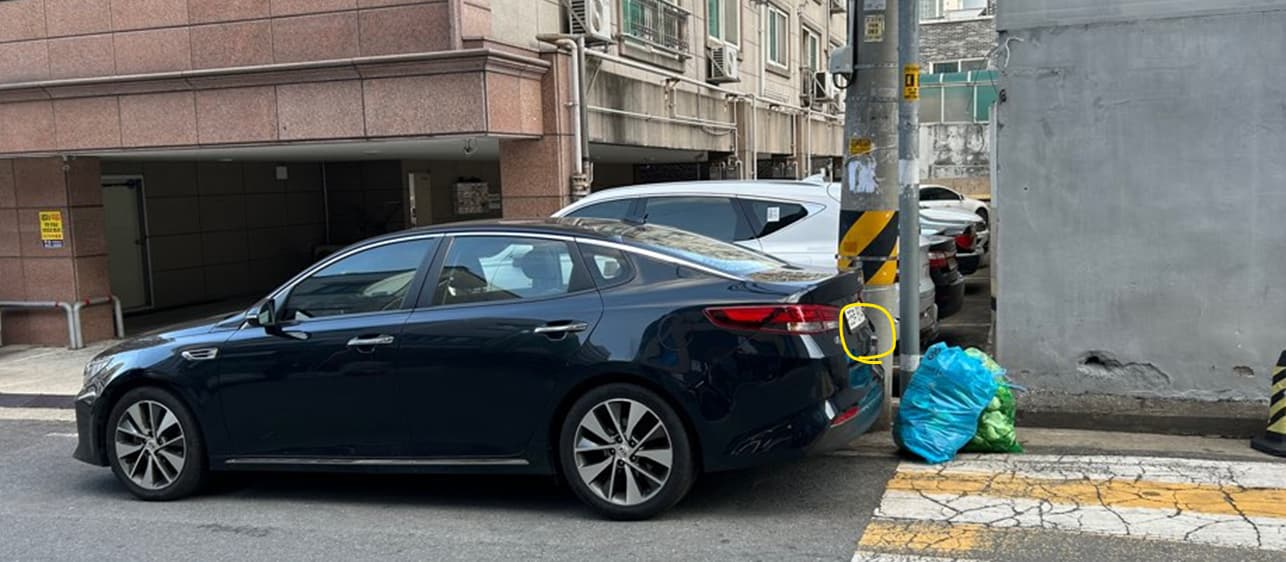

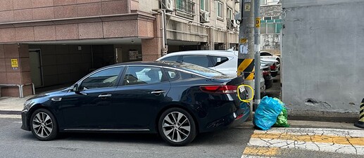

Inquiry 2) Is there a way to increase the maximum range for distance measurement?
The device is placed in the central console box of the vehicle, and when I am at the trunk of the vehicle as shown in the picture with the app turned on, it does not measure the distance.
I would like to increase the range at which distance measurement is possible.

About inquiry 2:
What you can do to increase the range, is to increase the transmit power of the device.
This will get you more range, but you’ll not be compliant with FCC regulation (transmitting at -41.3 dBm / MHz).
To do this you can change these values below to 0xFFFFFFFF (maximum power):
#define DEFAULT_TX_POWER_REGULAR_PULSE_AOA       0xa6a6a6a6UL
#define DEFAULT_TX_POWER_REGULAR_PULSE_NON_AOA   0x8a8a8a8aUL
#define DEFAULT_TX_POWER_ALTERNATE_PULSE_AOA     0x93939393UL
#define DEFAULT_TX_POWER_ALTERNATE_PULSE_NON_AOA 0x63636363UL

I have confirmed that the range has increased.
Could there be any issues caused by setting the TxPower too high?
The issue is that you do not comply with FCC regulation. So you cannot certify your device as it is with the actual transmit power.
