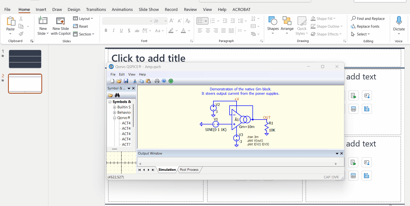

I rely on this feature to make sure all my screenshots fit perfectly into my ppt templates. Here is an example.

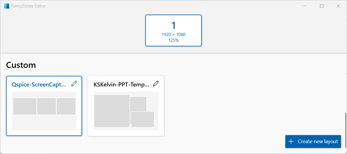

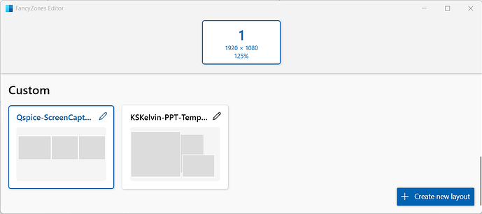

FancyZone
Here is a screenshot of a custom FancyZones setup. I think you can find more information on how to use it on YouTube or Google.
