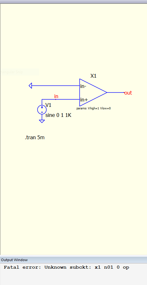

I’ve been watching this introduction to create a new component from Marcos Alonso but when I try to run transient analysis I keep getting a fatal error.

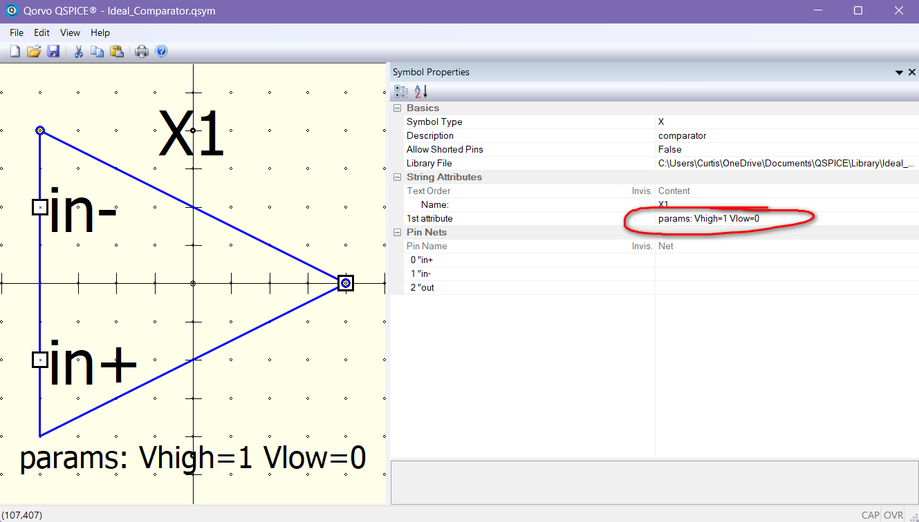

You call a .subckt, and the 1st attribute should be the name of your .subckt, and after that you can have parameters…
Change <model>
to comparator in this symbol.
Ideal_Comparator.qsym (621 Bytes)
