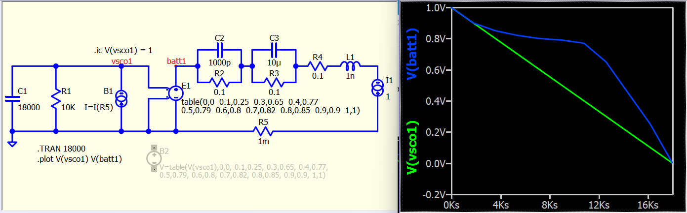

I have LTspice model that i am duplicating the same in Qspice but it shows error using E sources and table. Can somebody help me duplicating in Qspice with suggested corrections.
I am attaching LTspice Model and Qspice Model.
LTspice : Lithium Batt Spice Sim - Google Drive
Qspice version 1:
TEMP.qsch (9.4 KB)
Qspice version 2:
Use of Behaviour source than E1 source.
TEMP v2.qsch (8.8 KB)
Also please suggest how to to add lookup data in Qspice?

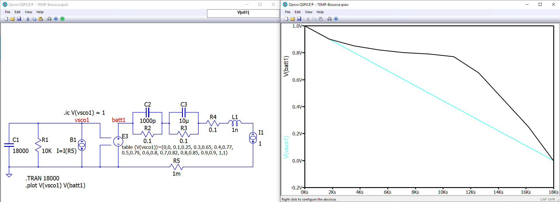

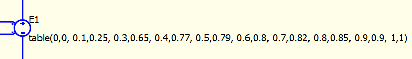

It seems Qspice must have comma between data in table() function.
TEMP-addcomma.qsch (9.4 KB)

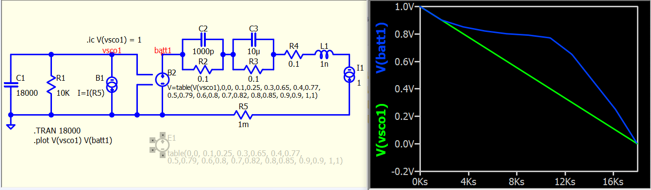

However, it seems currently E-source with table() has an issue, and here is with B-source to replicate LTspice simulation result as a temporary solution.
TEMP-Bsource.qsch (10.3 KB)

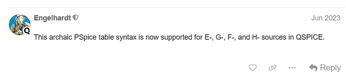

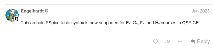

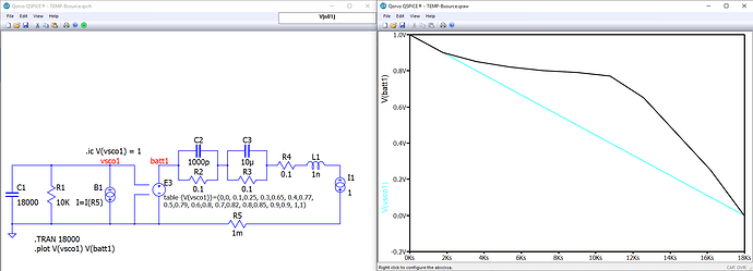

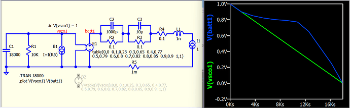

Update to latest version of Qspice, and E-source is now supported with LTspice table syntax.
TEMP-Esource.qsch (10.3 KB)
