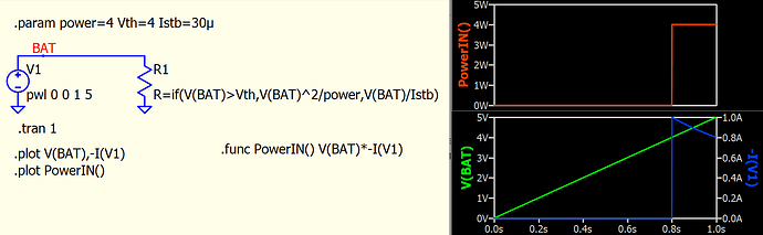

I wonder if anyone have any suggestion or solution they could kindly share, on how to make/implement a constant load that can transition between states in a smooth way that doesn’t make the simulator get stuck in the transition state?

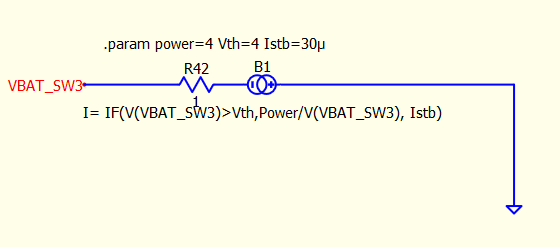

This is my current implementation, that get stuck as soon the VBAT_SW3 reaches 4 Volt.
