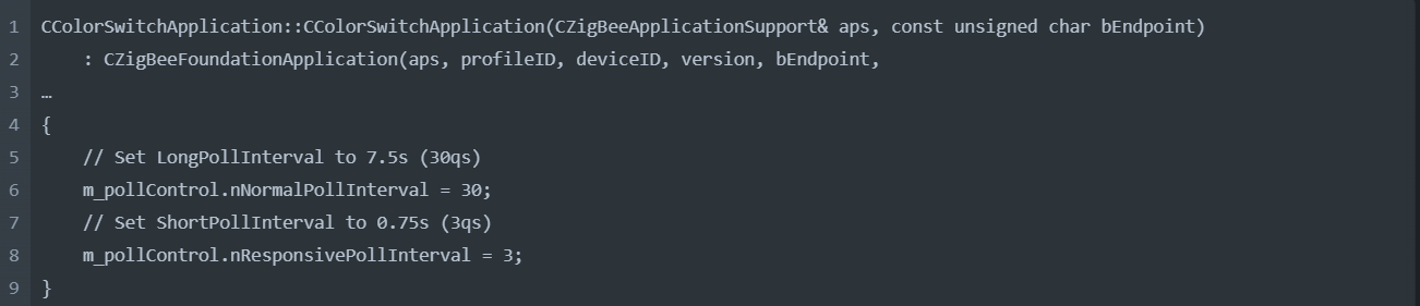

If the poll control cluster are used, the default poll intervals can be set in the constructor of an application class.
e.g. ZigBee Switch application : ColorSwitchApplication.cpp
