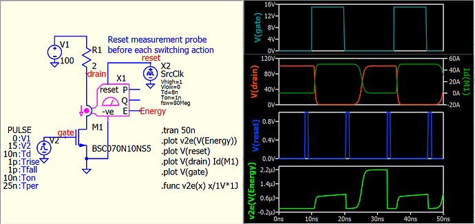

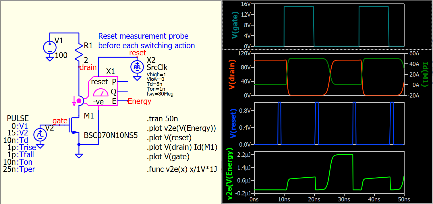

I created a power, charge, and energy probe symbol that you can download from my Symbol Library in the fixture folder. Here is an example of how it may be achieved.
example.MOSFET-ON-OFF-PCEProbe.qsch (8.5 KB)
