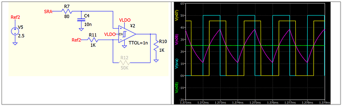

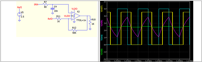

Hi everyone,
I need to use a comparator and, as explained by @KSKelvin (Confusion on understanding the Schmitt Inverter device - #3 by carlvanwormer), I’m using the HMITT function with the standard configuration; I don’t use VT and VH.

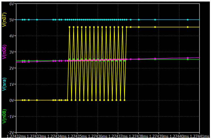

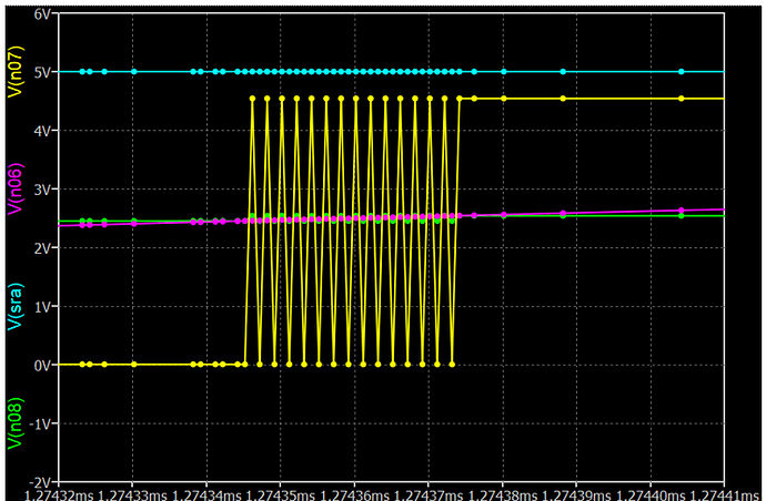

If I don’t introduce hysteresis, everything is fine, but if I use hysteresis, I get oscillations and I don’t understand where they come from.
Is there someone who can help me?
Thanks for your help.
Hysteresis comparator is positive feedback!
Oops, yes of course :joy:, thanks a lot.
