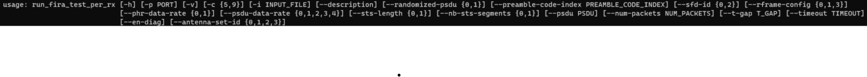

I am trying to receive packets on Qorvo QM33120WDK1 and I have two questions regarding the arguments of the run_fira_test_rx function

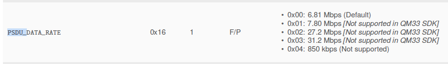

  1. The QM33120W datasheet mentions that it supports 850kpbs data rate. I know that the default psdu_data_rate supporting is 6.81Mbps, but I am not able to come across the option to change the PSDU_DATA_RATE.
How can I change the PSDU_DATA_RATE to 850kbps?

  1. There is a description in the provided document “uwb-uci-messages-api-*.pdf”
    I don’t see the --psdu-data-rate option in my uwb-qorvo-tool but, that’s the one anyhow.
