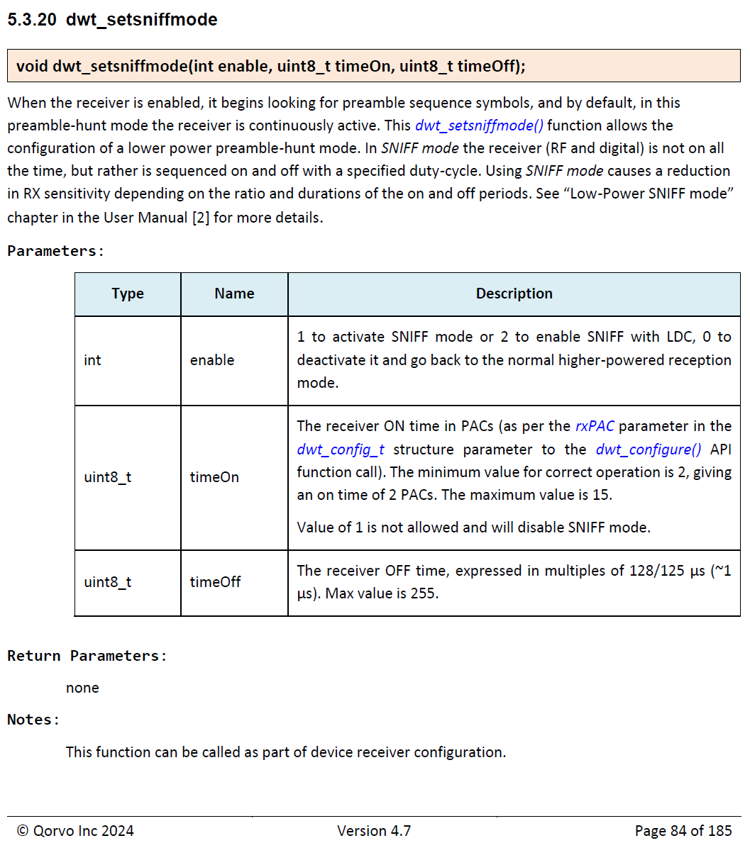

I’m seeking clarification regarding the Low Duty Cycle (LDC) functionality mentioned in the DW3xxx / QM33xxx Device Driver Application Programming Interface (API) Guide, version 4.7, section 5.3.20 – dwt_setsniffmode().
The documentation states:
int enable— 1 to activate SNIFF mode or 2 to enable SNIFF with LDC, 0 to deactivate it and go back to the normal higher-powered reception mode.”

When I attempt to enable SNIFF with LDC using:
dwt_setsniffmode(2, timeOn, timeOff);
the receiver behavior appears to not work as if not sniffing at all. I switch to mode 1 and it works as expected.
