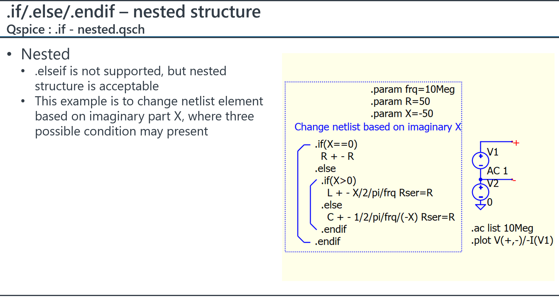

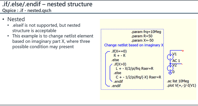

About nested .if
I think what you are currently looking for does not exist in QSpice; If the .if directive supported elseif condition, it would be quite close to what you want. But currently, it only supports .if/.else/.endif. Conditional statements can be nested, but in your case, it would be very hard to read. I have used a two-layer setup before.
