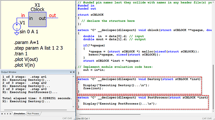

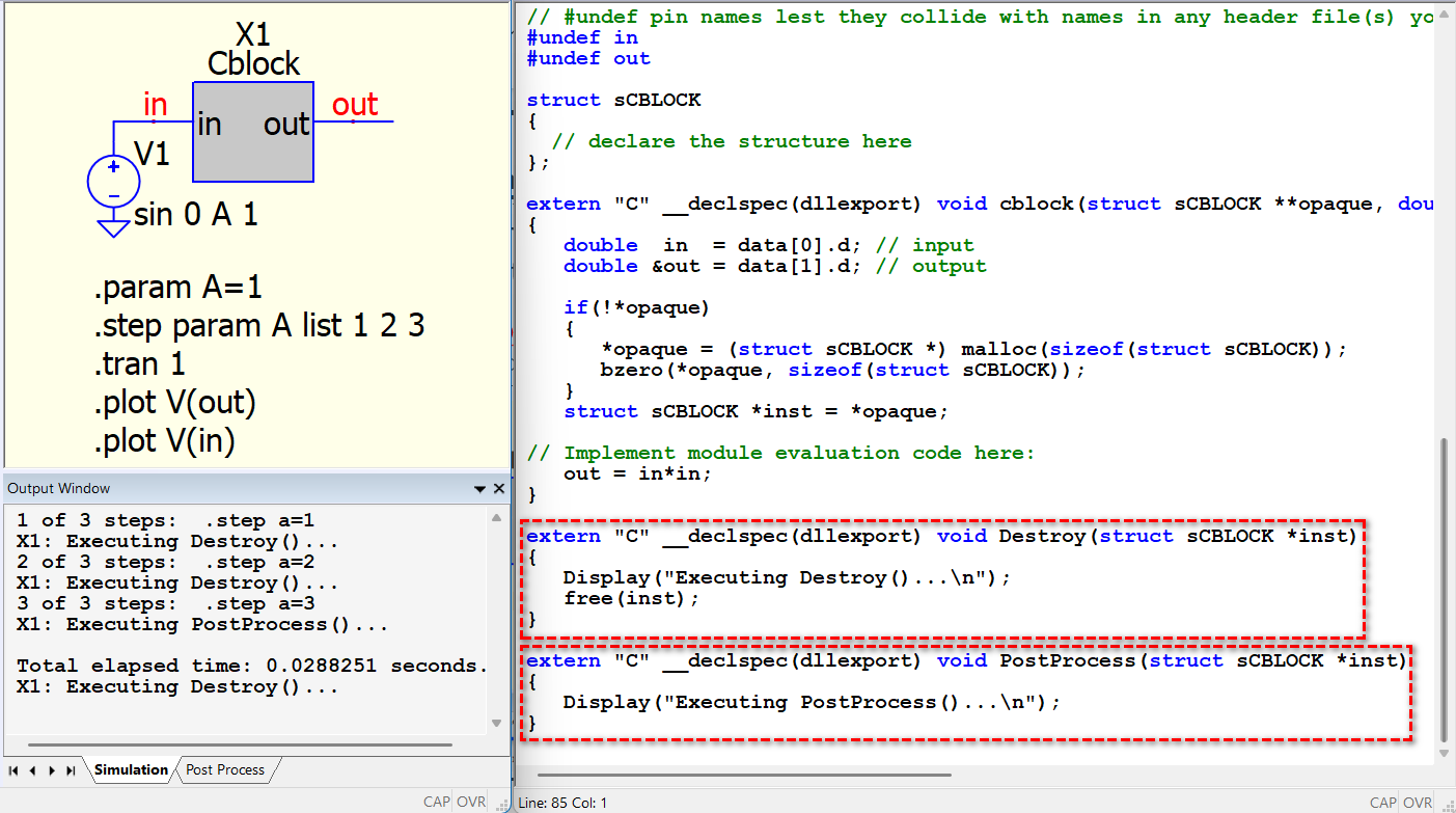

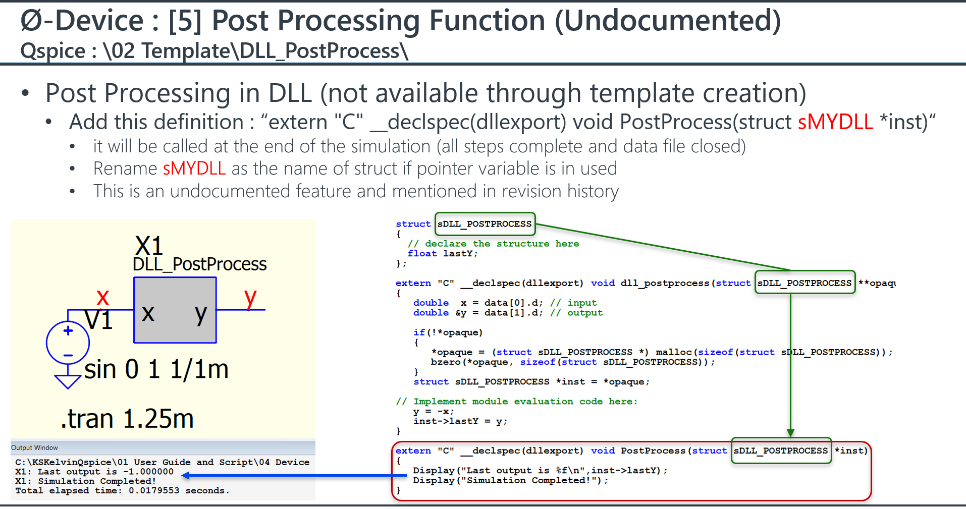

Well, if you only need the result once before the simulation completes (rather than after every .step finishes), you can check if the undocumented PostProcess() function can help. You cannot create this from a template, but you can manually add this function. As you can see, PostProcess() is run before showing the elapsed time and executing the final Destroy().
DLL_PostProcess.qsch (1.5 KB)
cblock.cpp (3.6 KB)

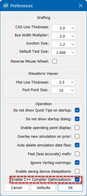

Maybe you can disable this to see if this weird issue disappears. I do not have any information on the background of why it was introduced, but I just noticed it in the revision notes, must be solving someone issue.
06/23/2026 The C++ compiler optimization is now optional.
Arief, please try running from command line without the changes. I’m curious if that also drops the output.
For now, the dll is compiled via vscode, I think the compiler option from Rob’s vscode task doesn’t invoke optimization yet.

Anyway, @KSKelvin what’s PostProcessing function in Cblock? I believe I haven’t seen one ever.
This is an undocumented function that was only mentioned in the revision notes. My impression is that it was a response to a request from @RDunn.
  • 08/31/2024 Now if you define a “extern “C” __declspec(dllexport) void PostProcess(struct sMYDLL *inst)” it will be called at the end of the simulation(all steps complete and data file closed).
Thanks,

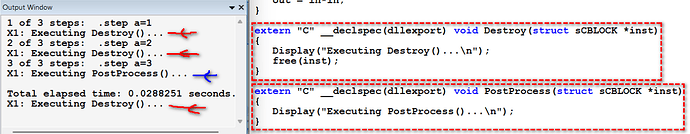

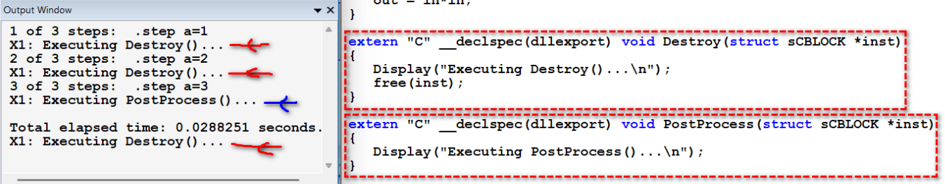

So, Destroy() is called at every step (I have tested this), while PostProcessing() is only at the very last step?
PostProcess() is called at the last step, but it runs before Destroy() of that last step to ensure that member variables are not cleared up when calling PostProcess().
