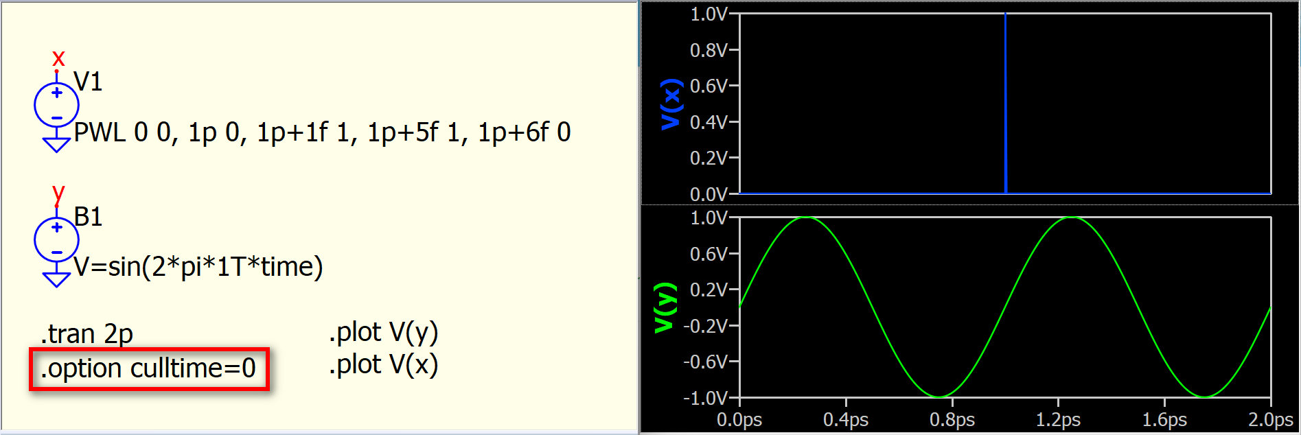

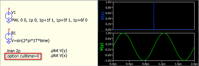

You can play with timestep in fs, but the key is to have .option culltime=0, an explanation can be found here : Transient time resolution limited to 2ps - QSPICE - Qorvo Tech Forum
