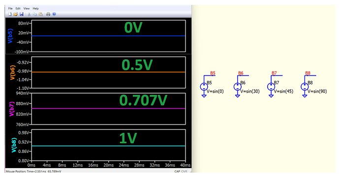

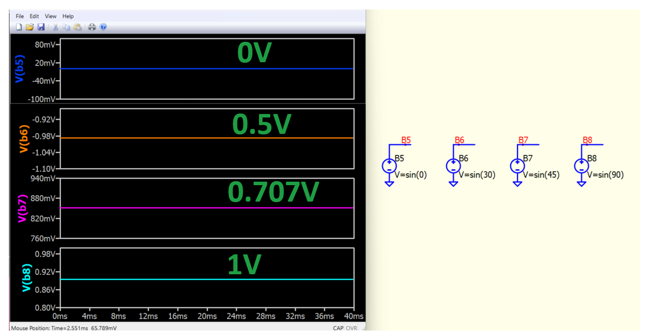

Hi,

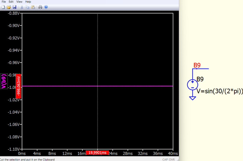

I am not sure why behavior source give this kind of results. The correct results are written with green in each plot. I am missing something? Or to obtain the correct results I need to do in a different way?

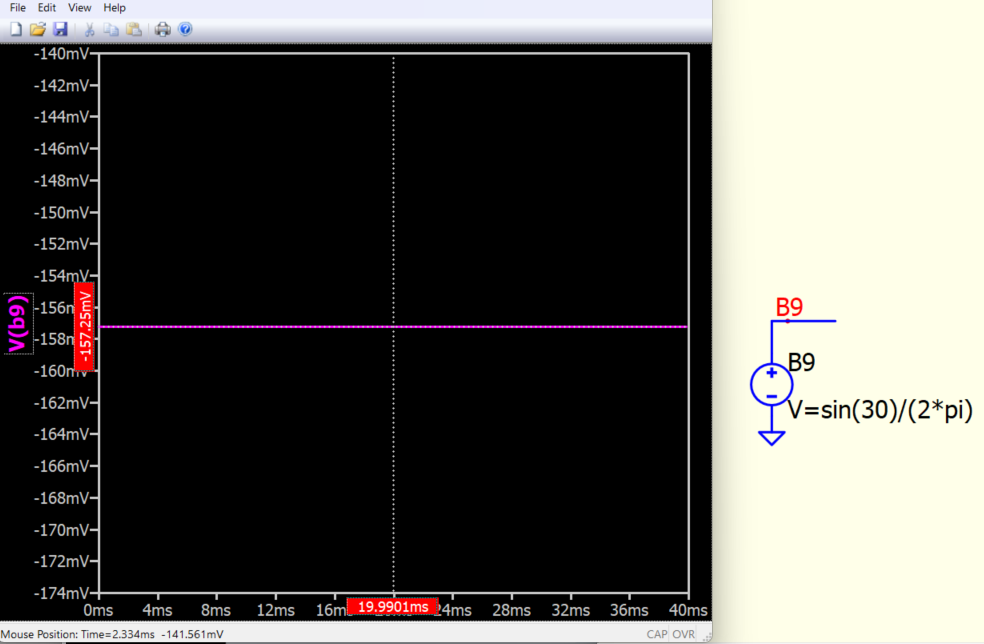

I tried also like this but without obtaining the correct answer:
sin(x) where x is in radians.
if you input with degree, sin(<val>*pi/180)
