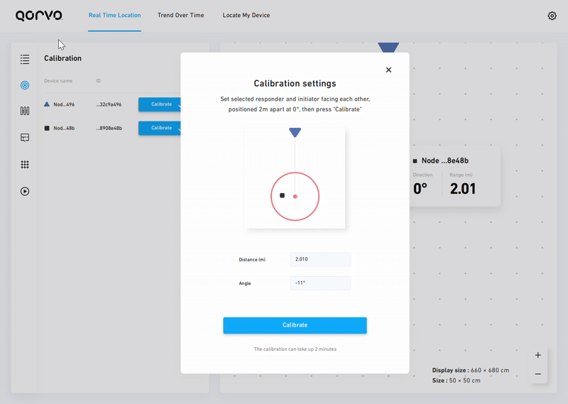

I am doing AoA measurement inside a chamber using the qm33120wdk1, but the AoA fluctuation is very random after auto calibration on GUI. I would be glad of any help reaching a solution or the reason behind it. An evidence is attached.
ezgif-8b9c63b56351ba

Someone more experienced with UWBs may be able to provide a better answer, but you will almost always have some (pun-intended) degree of noise involved with measurement hardware. By your attachment, it appears you are within plus/minus .05 degrees, which is pretty good for a lot of applications (though I do not know your use-case).

It is expected to have fluctuations in the AoA readings as @Joshua_Bays indicated above. You can perform averaging by collecting a certain number of samples to have a more stable AoA readings but it would reduce your measurement frequency.
What is your requirement in your application for the AoA readings?

My first goal is to understand the accuracy level of the kit, and I am trying to get as precise as possible. Thus, I was wondering if the fluctuation is unusual, and how many samples. I use CLI mostly to get the values, but for angle calibration, the number of calibration attempts vary.
