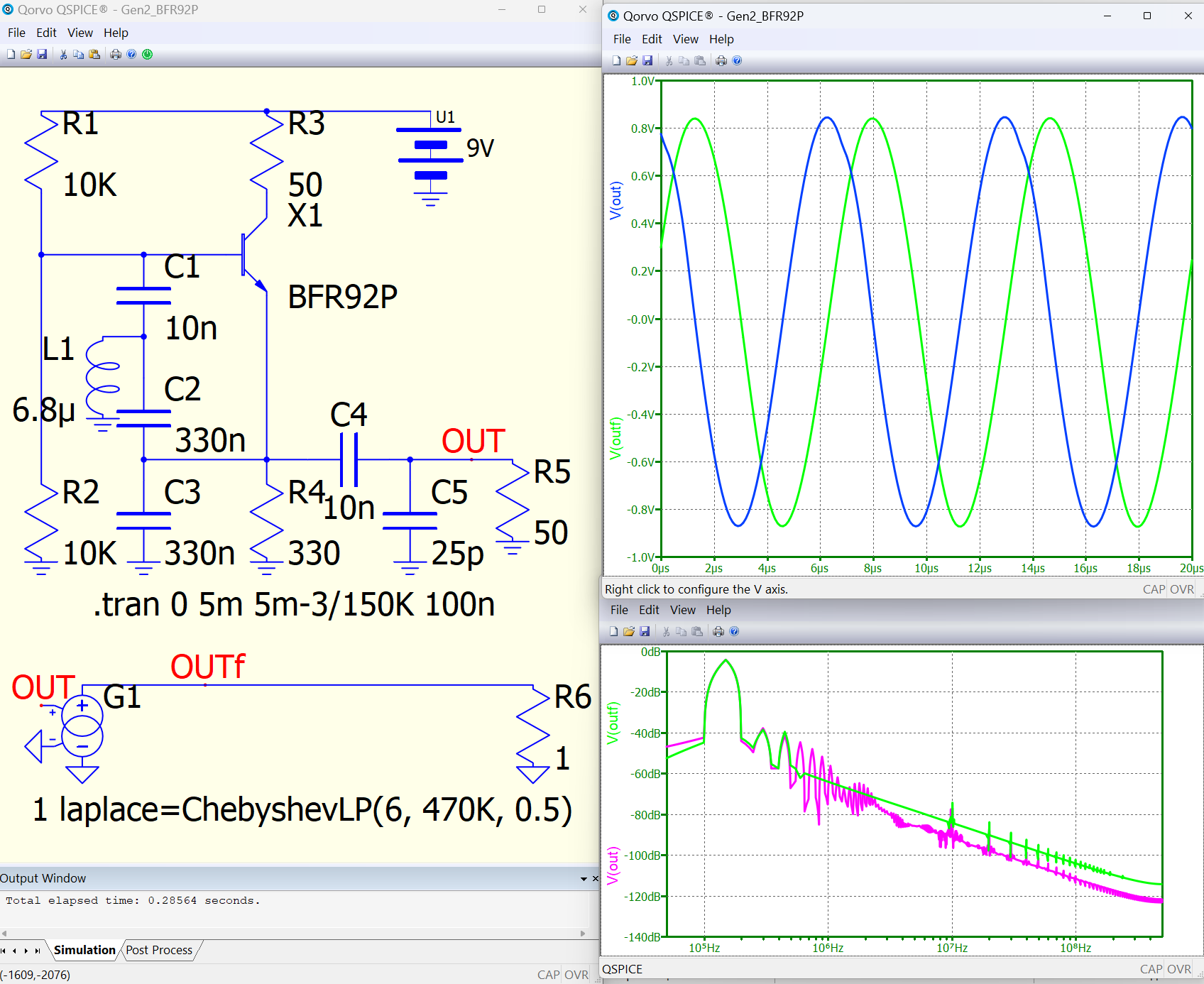

Any one has oscillators done in Q_Spice
any one has oscillators done in Q_Spice
See
Can you share the schematic

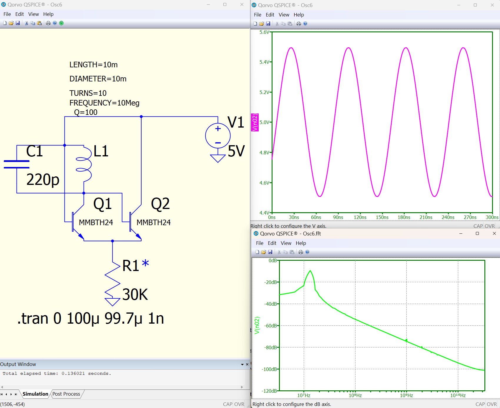

S
Osc6.qsch (4.9 KB)
ee

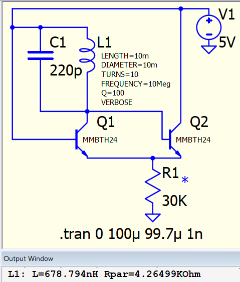

This example just remind me that you can add Instance parameter Verbose to return computed value of L when using LENGTH, DIAMETER and TURNS.
Osc6-VERBOSE.qsch (5.1 KB)
