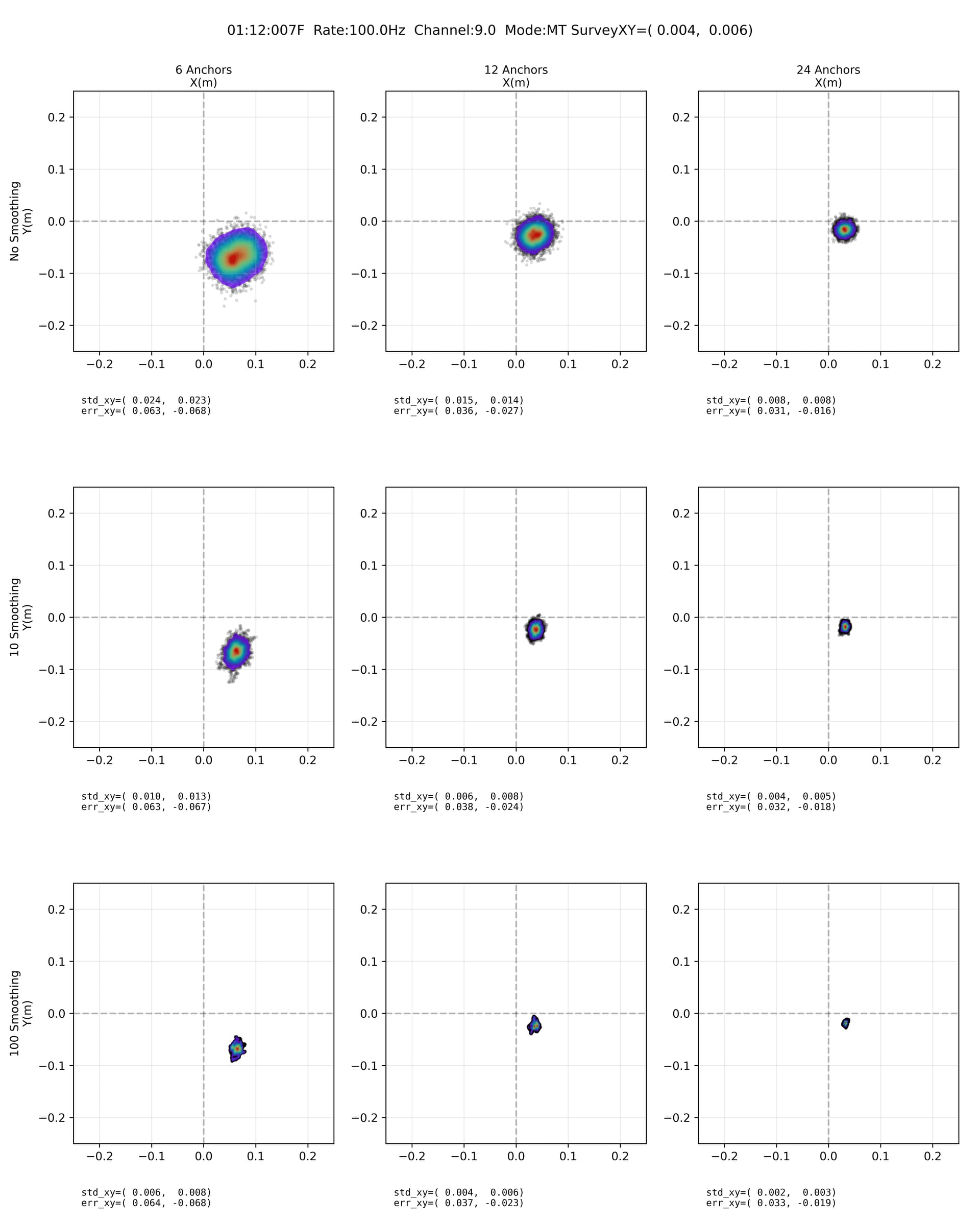

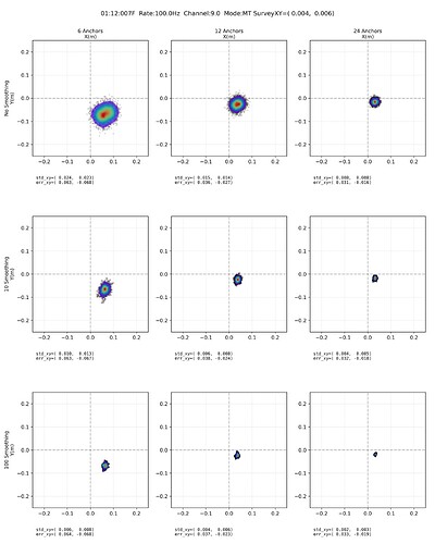

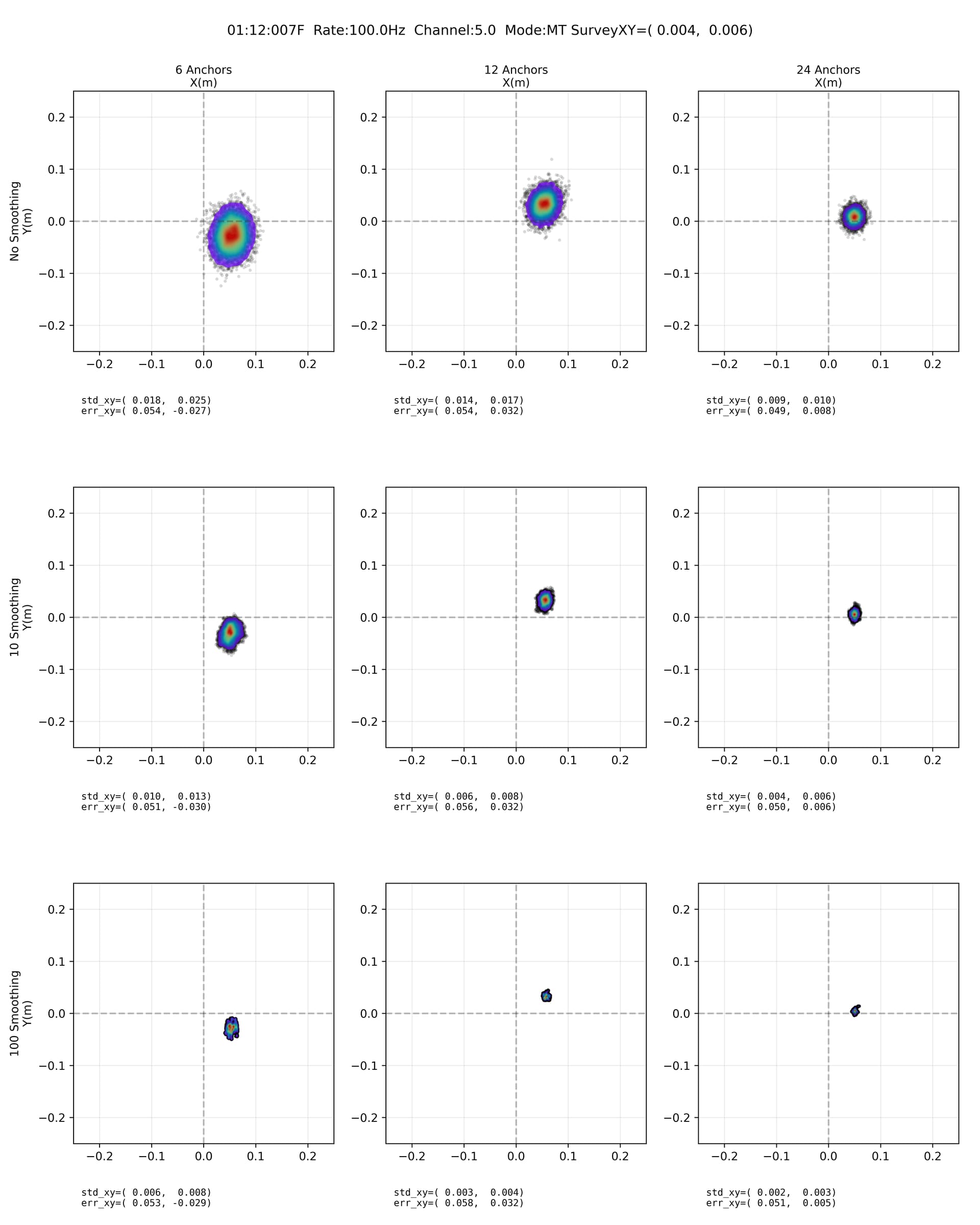

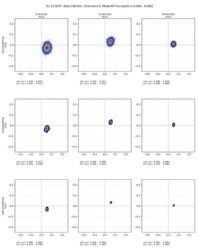

Here are the results in these two files (click for larger view) The charts are all +/- 25 cm from ideal (about +/- 10 inches).
The plots are only XY plane. Z axis is less accurate in general for an anchor array in one plane on the ceiling. The tag is at the (0,0) point in all these images as surveyed by a total station.
With no smoothing and 6 anchors, the worst case in these plots, the position std dev was 2.5 cm or less for both ch 5 and ch 9. With 24 anchors and 100 smoothing, a “ridiculous mode”, the std dev was 3 mm or less. Overall Accuracy was well within 10 cm.
