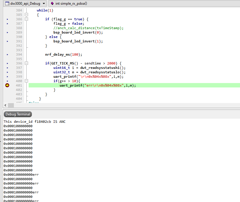

Hi, Akash
To track this error, we added a loop in the main loop to print . It appears that DW3120 is still responding to SPI queries, but it is no longer pulling up the interrupt line. It is unclear what state it is in.
