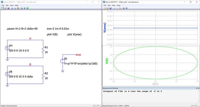

I am working with Lissajous curves and I have found something strange when calculating the area of the curve using Qspice. For example, in the attached file the curve is just a circle of radius 2. Qspice gives an area of 4 instead of 4*pi. For other elliptical curves it always seems to miss the factor pi. What can be the reason?
