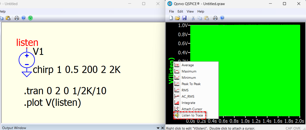

The “Listen to Trace” function works correctly on my computer by Ctrl + Right-clicking the trace in the waveform viewer and selecting “Listen To Trace.” This is the only method I am aware of. Is there another method that could listen to a trace in the past but is no longer available? Or perhaps this feature is not functioning on your computer?

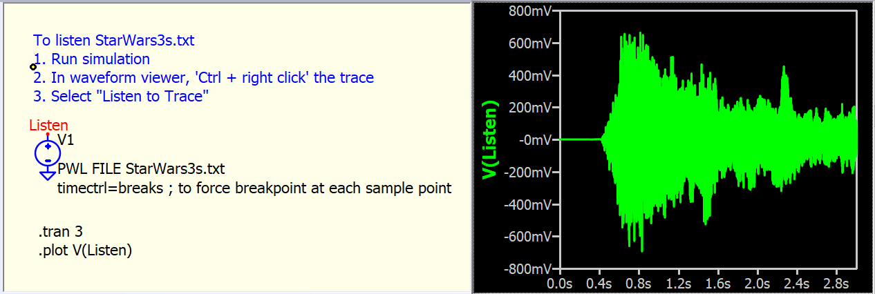

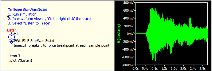

Converted a .wav file and it also working
StarWars3s.txt (1.1 MB)
Qspice-Play-Sound.qsch (1.1 KB)
