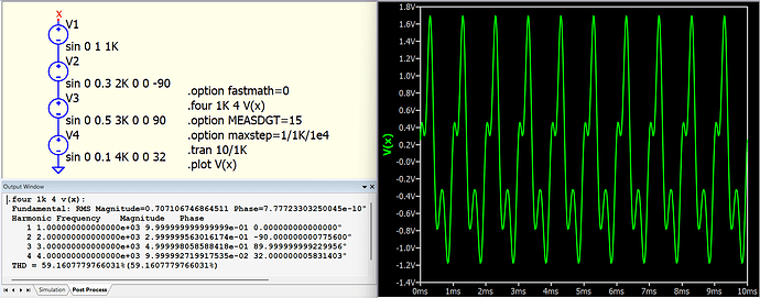

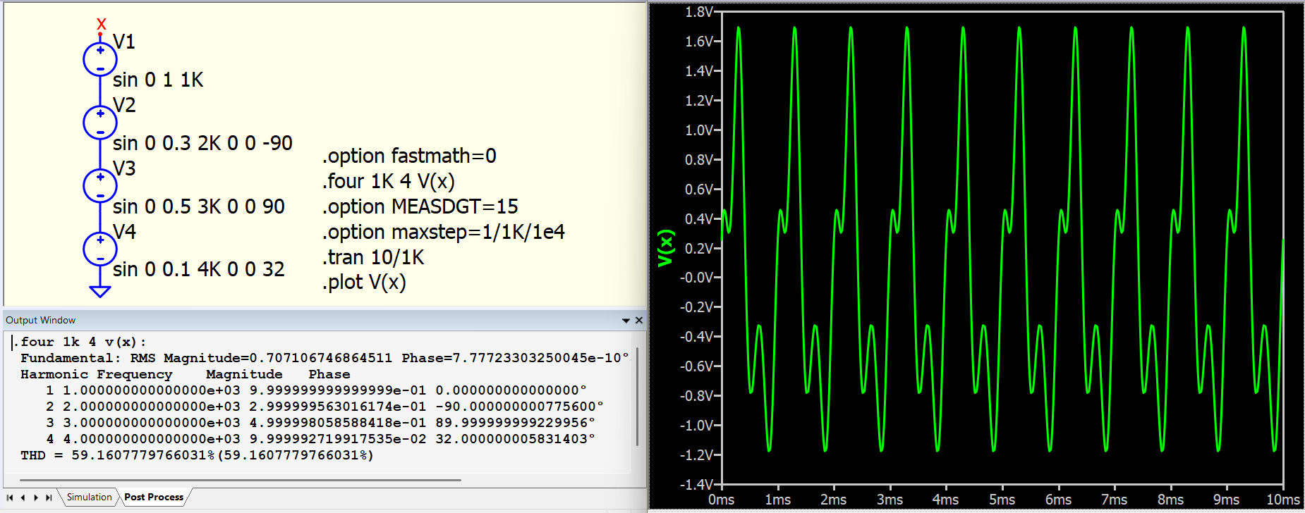

Here is an example to generate a distorted sine wave with harmonics, with 15 significant figures specified.
Based on your screen capture, I believe you post video to compare excel and Qspice (https://www.youtube.com/watch?v=NcomvddNjb0), and I have a feeling that you quote results from other instead of running your own test. Therefore, I also upload this .qsch file and you can download Qspice and run a test on it.
four.qsch (3.3 KB)
