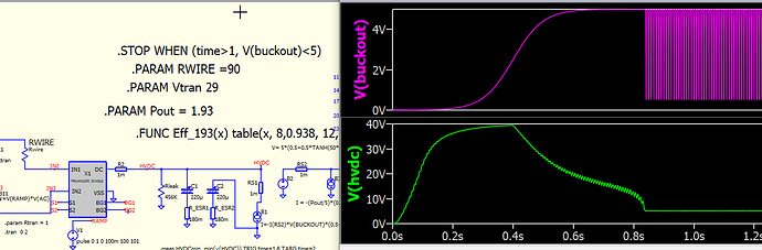

Running lots of transient sims, and if my 5V buck drops out of regulation, I want to abort the simulation. I used .STOP WHEN (time>1)*(V(buckout)<5) and this is ignored.

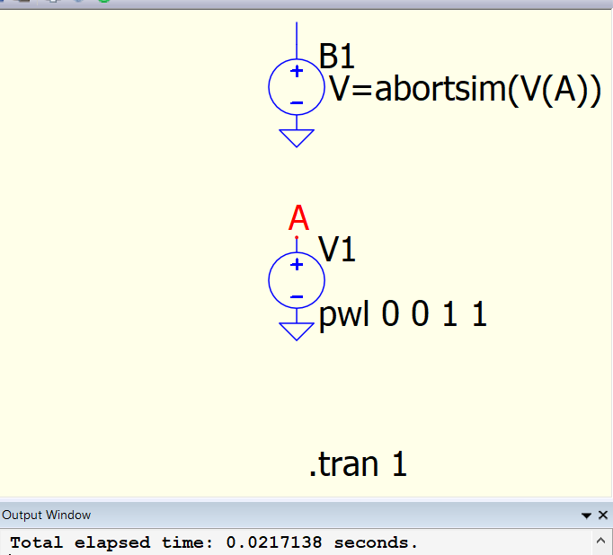

You need to use B source with abortsim function.
abortsim(V(A)) → when V(A)>0.5 → stop simulation

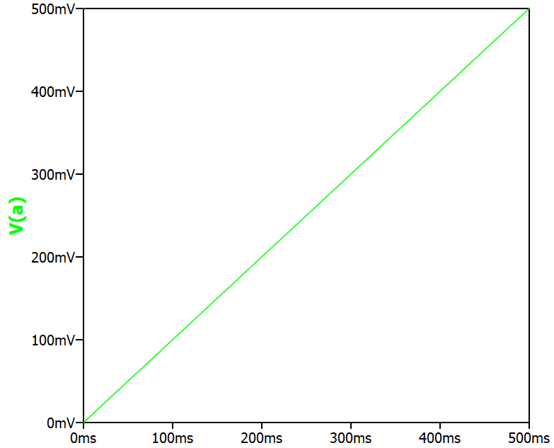

When I try this simple example it works without a issue.
