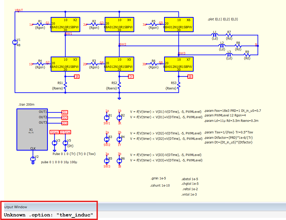

i am doing 3 phase inverter simulation with spice model of the mosfet. simulation is not even completing 0.1%, too much slow. any setting needs to be applied ?
It is necessary to make the control signals smooth using additional parameters of the Rser and Cpar controlled sources.
